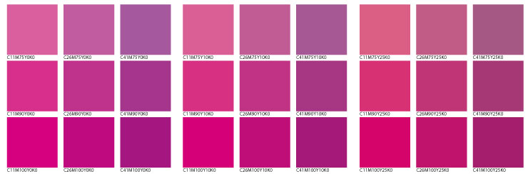

So I tried it out and perhaps I am doing something wrong, but when I do values of 100,89,38,34 with 5% between, It generates the swatches but im getting a bunch of white swatches with values of 0,0,0,0. See attached image. Any idea whats happening?
the white ones would be duplicates as there is no 105% to continue the cycle if that makes sense, so all the combinations are actually there with duplicates removed
