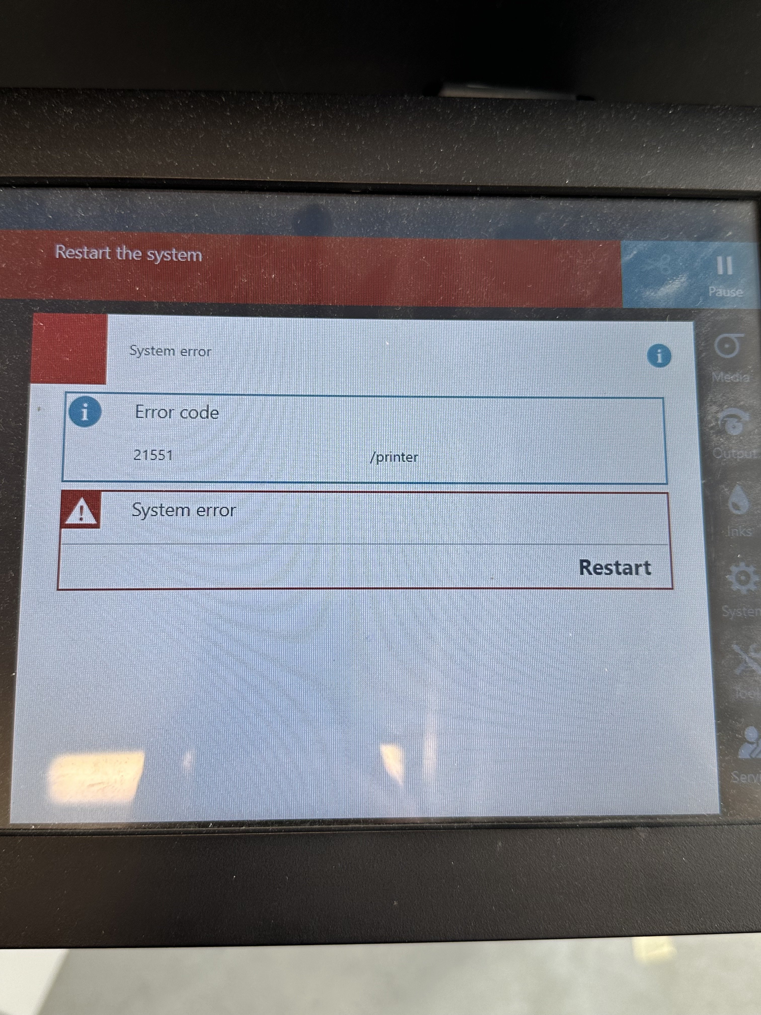

Hello, first time poster, long time lurker!
We've been struggling to clear error 21551 from the printer. It pops up after you feed the media and start to print anything (we've used the printhead quality chart, test print and a print job to troubleshoot), the printhead does a scan to the right and as it reaches the end of the platen, the error pops up, the head goes back to the maintenance station and it requires a restart. The technicians have swapped out numerous cables, the M&C scanner, encoder strip and the encoder (may have swapped out other things in the carriage system) to no avail. I was hoping perhaps any of you have had experience or perhaps any ideas on what to further investigate (the techs are scratching their heads as well at this point)

I dont think you're looking at the right error code.
What's the screen say when you tap the information button.

Oh wow, Sorry, i've never seen such code. Usually it's Printer/YMS_05 or something. Not just Printer/
What version are you on? i think you're on 2.5.x ?

Does the carriage clunk when it homes to the left? There is a home tab that can get worn out and you simply bend it back so the switch is activated before hitting the hard stop.

No, nothing of the sorts unfortunately. It's a smooth ride all the way, feels like something on the software or sensor side of things, like it can't get a signal or a go-ahead.

Well, we finally got it up and running and the error cleared. Turned out the PCB of the printhead had a faulty port that connected to the m&c scanner, swapping the PCB board out fixed the issue. Thank you all for your inputs!
