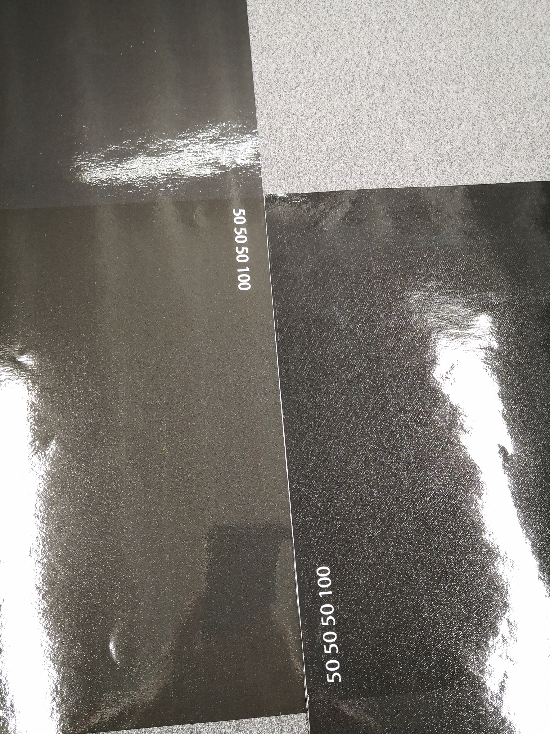

Yes it is, as much as it can be from this printer :) but is not dense enough and really far from rich black. We spent months on that issue, together with our ink/machine supplier and the conclusion is that this is what the machine can deliver as black color so far, with these inks.
Zhivko Yanakiev
can you show us a photo of the issue?
Same file with the corresponding media profiles for each printer - Colorado 1650 on the left, Latex 560 on the right. The foil is Avery MPI 2800.

can't say mine does that. there's an issue for sure.
how dark is it compared to the print quality test off the printer?
If you turn "all icc profiles OFF" does it do it?
Are you sure there’s nothing wrong with the printer? Heads? That looks like you’ve run it on speciality judging by the pass size and I can still see slight banding. I’ve never had banding on specialty on the 1650 or the 1640. Get much better blacks too lol

The printer is fine :) A couple of days before that picture was taken we left the printer to work after we left. So... paper crash... printheads over the platen all the night... many missing nozzels on the next day, but now it's fine. I mean that the black is the same shit with or without the banding from the pic :)
