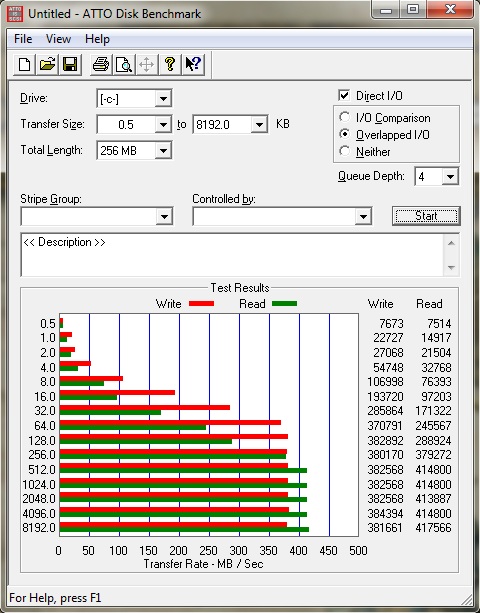

The transfer rates that I saw for the external transfer methods (the first three benchmark transfer speeds) seem correct, but the internal transfer bandwidth is what threw me for a loop. Your average 7,200rpm SATA hard drive will range in the 80 MB/s transfer speed. I found this average by numerous benchmarks on the internet rating hard drive speeds.
A VelociRaptor averages in the 100 - 120 MB/s transfer speed. Even in RAID 1 it should outperform a standard 7,200rpm SATA hard drive because of it's spindle speed and access times. I have two OCZ Vertex SSD drives in RAID 0 in my computer, which blow traditional mechanical drives out of the water in terms of average transfer bandwidth, and even then I can only achieve about 400 MB/s transfer rate.
This is just why the numbers I saw on internal transfer rates threw me for a loop. The only thing that approaches 1000+ MB/s transfer speed is either numerous (six or more) high-performance SSD drives with a powerful RAID controller, or the actual transfer speed between CPU and memory.

I guess we can go back and look at teh DiskBench program and see how it works...
I expected the raptors to be alot faster than the 7200 IDE also!! I am sure that they are, but this utility may be the culprit. My bet is that the disk cache is throwing the numbers off.
I'll hunt down ATTO and see what I get.
The analogy is still good:
Don't use USB to hook up an external HDD if you can find a better way!
