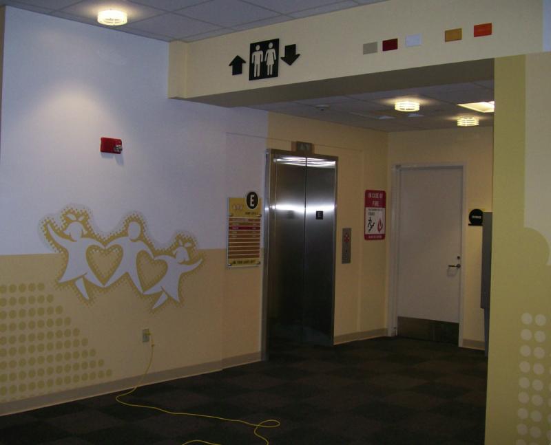

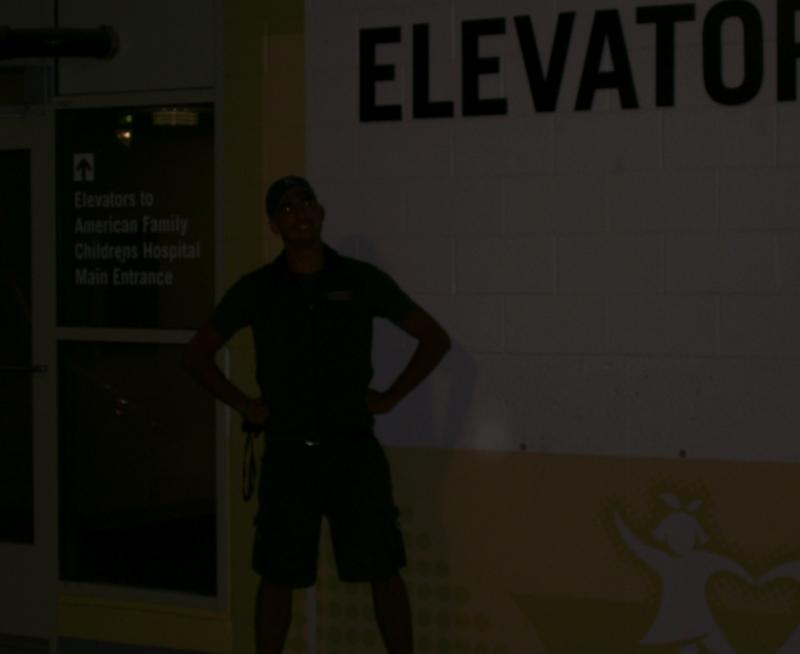

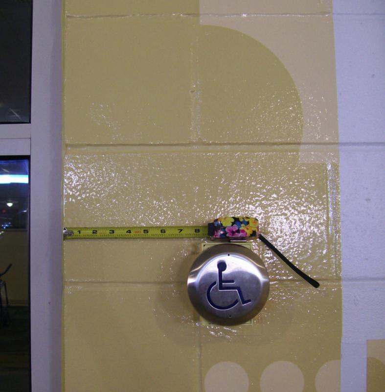

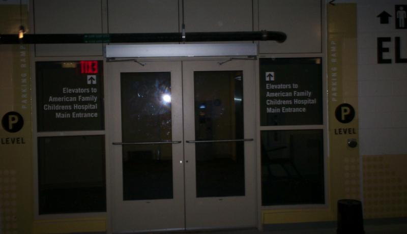

some quick pix.
p.s. that's NOT my tape measure. Our shop sign-gal enjoys using "flowery" tools so that I resist the urge to lose them in my toolbox :)
