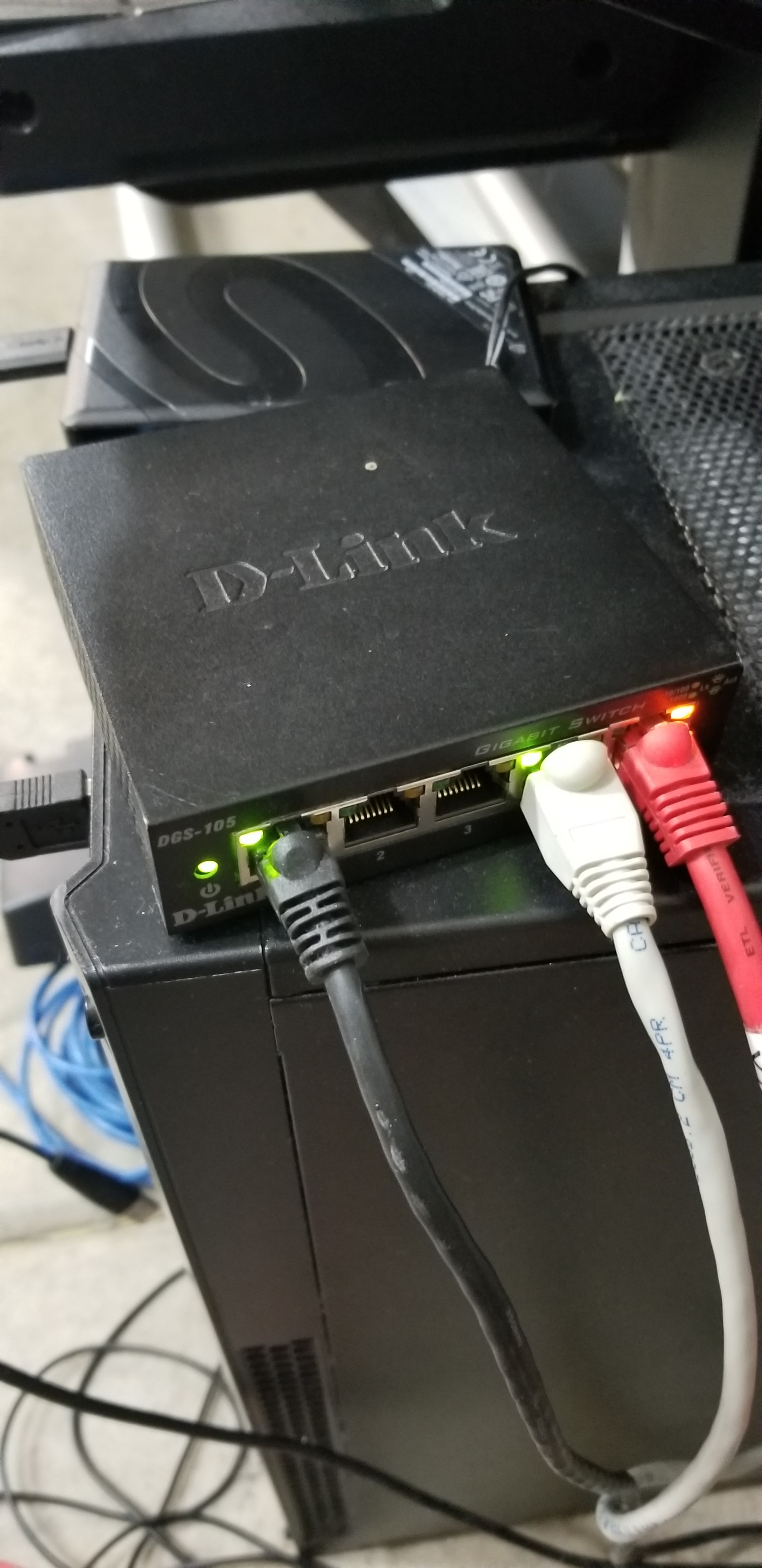

This is how I have it connected thru this D-Link where I have my HP Latex as well.

That's a switch so it should work fine. Sorry I can't really help you with the MAC side. Double check if the IP address actually saved properly because ValueJets tend to be wonky and don't always save the IP address for some reason. Then just make sure you have the printer's IP address in Caldera. Also, it would be very rare but if you have another device attached with the same IP address that would mess it up as well.
