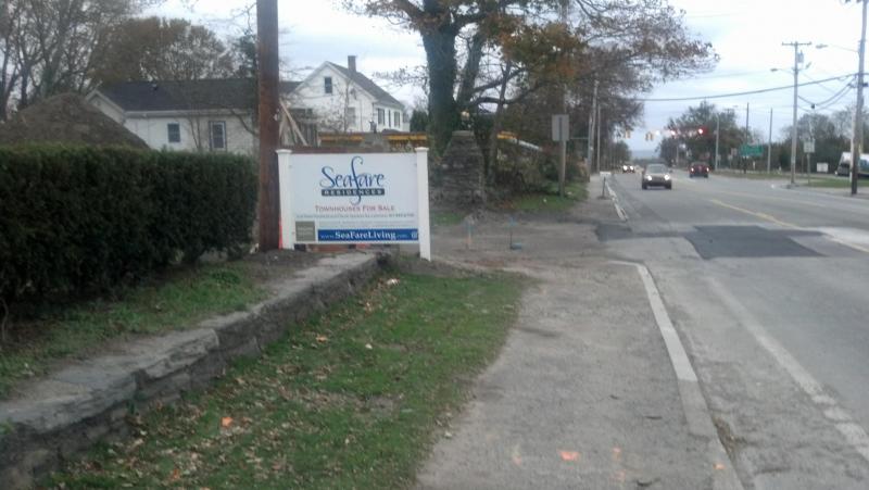

    I've done a few construction signs for condo complexes going up and I like to use 1/2 PVC with a print on both sides (decent air release intermediate print vinyl and coresponding laminate) I have a local fence company that has 4x4 white posts with caps that make the whole thing look nice. (attached with white sign clips)

  12. 401Graphics
    401Graphics Very Active Member
    nice!
