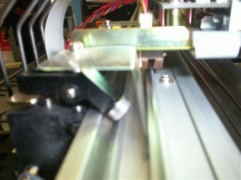

Still getting the 070 Yencode error and have tried numerous "fixes". Its has been suggested that the heads be changed, I cannot see how this would be a solution, after exstensive research I believe it may be the y sensor, the head does not move in any position along the T strip. Is it possible to get this sensor? Haven't gotten a response back from mutoh and its been 2 weeks, other distributors have no idea. Any help would be apreciated, I have found alot of information on the Yencode error, but if no given solutions work, then what?

I am guessing that the Y sensor is not available by itself, just from my experience getting parts. And besides that just makes too much sense for a manufacturer to do! :Big Laugh I feel for you in trying to figure this out, but I'm guessing that you may have to buy the head board to get that.
Is this still the same problem that occurred after made some other repairs and then this error showed up after you put it all back together?? That just sounds like something's not connected right. Do you have a maintenance manual? I have one for the Jr. but not the 46". Iknow they are available on ebay unless some one on this site has a PDF of it they could get you.

This was a new problem after replacing the pump, the capping station and waste lines, and the Y sensor is not available on its own. At this point I have had it with Mutoh's complete lack of Customer Service and Support and am looking at Mimaki and Roland. My 2 year old Mutoh Falcon Outdoor 46 with the Y code error and new everything else is now officially for sale.

Dude I just went through the same thing...It's your servo motor. And if your machine is like mine the voltage on the main board was set too low (4.7) Should have been (5.3). I have gone through 2 servo motors until the tech realized it was the voltage. It also would make my machine stop printing in the middle of prints. Everyone said it was my virtual memory on the machine ripping the job...but NOPE it was the voltage on the machine.

I have a falcon jr and have got this code before also. I called my caligraph guy and he told me to clean the sensor with some denatured alc. and the strip that runs the length of the machine. I did this and fixed the problem haven't had it sense but i clean those areas pretty regular now.

If you can take the sensor off try to read the numbers on it and call www.DIGIKEY.com, thats where i got ic's cap's resistors sensors and more...
if you can't get the same kind loof for a similar on their catalog, after all it's just a switch, others of the same kind will do the same.
No!No! That stuff can be too harsh on the sensors.
Regular cleanings will prevent many errors but you should not need anything other than clean lint-free cloths/towels and possibly distilled water.

Had you tried the following
Use the selfdiagnostic
“Examination/Enc
oders” to check
Encoder Y
→ If it is no good, check
cable connections J112
(HEAD2) on the main board
and J202(MAIN2) on the
head board.
→ Replace the T fence
→ Replace the Y motor assy
→ Replace the head board
→ Replace the Y cable
(between J112 (HEAD2) on
the main board and J202
(MAIN2) on the head board)
