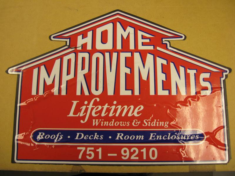

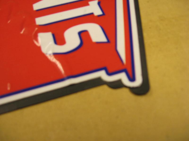

What they have now is 30mil. I think with printed vinyl on it & it's shrunk almost 1/4" all around. :doh:
that is alarming, a 12" x 18" having 1/4" shrinkage.
How old are the magnets?
Don't know how old they are, we didn't do these for him. See attached photos. The black around the edge is the mag material where the vinyl has shrunk.

to me that looks like they countour cut the magnet. Then printed a decal and contour cut that and then the sizes didn't match so they just stuck it on ther anyways.
