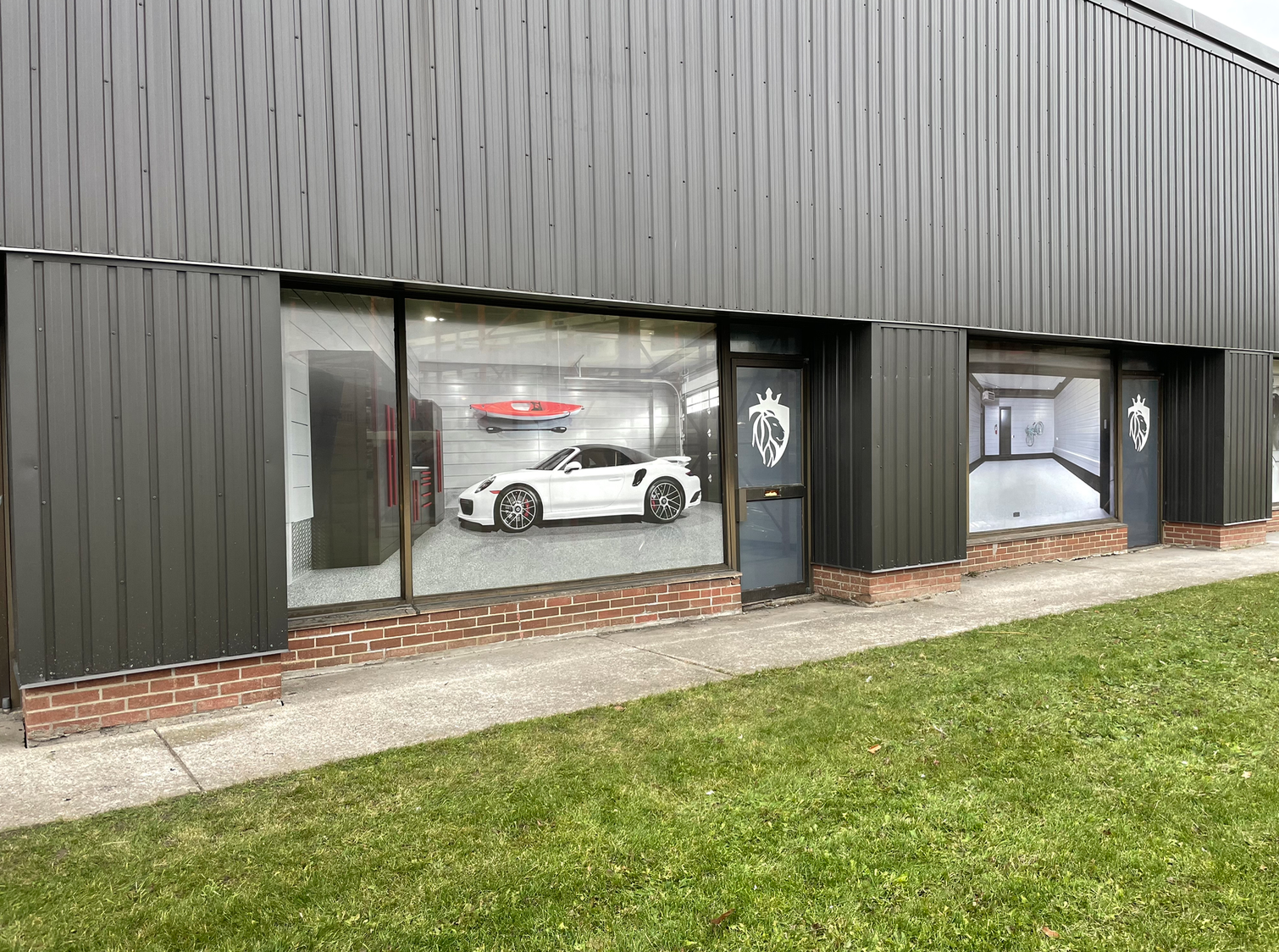

Finally managed to try out the Contravision perforated film. Happy with the results. I paired it with a 3M cast overlaminate and the overall look is great. My client wanted more coverage than the 3M IJ67 (60/40 pattern) we normally stock, so we went with the Contravision 70/30. One of the pros was the ability to apply to surface tempurates with a minimum of 5 degrees C (Contravision) instead of 10 degrees C (3M). Definitely more "tacky" than the 3M IJ67 perf. Great product and will be using this film moving forward.
