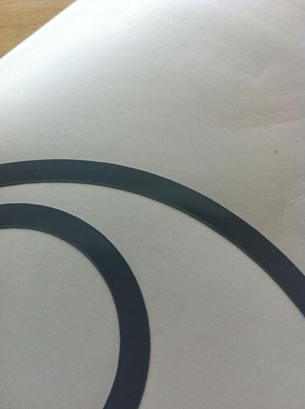

    I have a Copam 2500, and for the last while I've had a hard time with it cutting just horribly! I've attached an image of what it's doing. As you can see it's a really rough/jagged cut and it even causes the edge to come up a little bit. I've replaced blades and I've even replaced the blade holder. I've adjusted sizes, and it still cuts like this. Any ideas or recommendations? It's almost as if the blade doesn't swivel at all, and that's what the people I bought it from thought, so they sent me a new blade holder, but it's already doing this again, and I don't know if it ever stopped.
    Any ideas?
    Thanks!
    Andy

    Blade Holder, Protection strip OR the cut head assembly has a little play in it.
    Most of the time, protection strip. Sometimes the blade holder. And rarely the loose cut head assembly (but still possible)

    Ah, thanks! Ya, maybe that protection strip now that you mention it.
