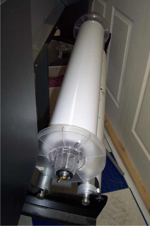

Jim, Our SP300V came with just what you are looking for. I believe the "technical term" is media flange. (picture below) I've never found them listed anywhere as a separate item though. I'd like some spares as we switch media frequently so I've been eyeing these:

I was waiting for a photo too! I couldn't figure out how the strainer could ride on the rollers like the Roland flanges do. Now I get it, they just give you a consistent surface up against the ring. That's a nice idea but I don't like to put the media print surface directly on the rollers so I prefer the flanges.
Bill43mx
Just a quick follow up on this topic. I decided to gamble the $29 on the set from sign warehouse rather than go with the $30 plus each ones from Roland. Just received them yesterday and am happy to say they do the job nicely. The flange portion on them isn't as robust as the Roland version so I don't know that they would hold up to 54" rolls of banner material but we intend to use them for the small rolls of specialty vinyl that get swapped in and out frequently. For that use they seem perfect.
