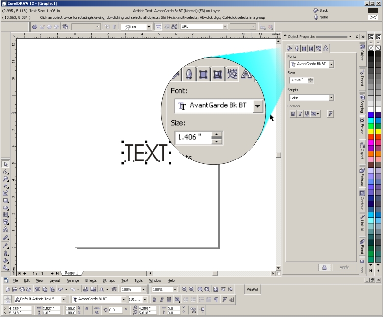

    Anyway, here's another option under your "Object Properties" docker...
    Checkers

    I was able to find where I can select font height as you provided but that isn't what I'm trying to accomplish. <o:p></o:p>
    <o:p></o:p>
    I need to be able to diagonally stretch a word to get an exact width while keeping the height ratio correct. <o:p></o:p>
    <o:p></o:p>
    Or better than trying to hand stretch the word, I need to be able to lock the padlock and enter 120" in the width box and it immediately stretches the font to exactly 120". <o:p></o:p>
    <o:p></o:p>
    Now, I know that I could stretch the font diagonally and watch the real time readout in the bottom left corner of the Corel screen, and get it close to 120", but it is hard to stretch a 10' word to 0.001" <o:p></o:p>
    <o:p></o:p>
    It is much easier to just type in 120" and let the software do the dirty work. <o:p></o:p>

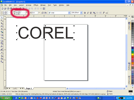

  13. Shovelhead
    Shovelhead Major Contributor
    10,882
    15
    Dec 5, 2003
    I'm running........
    Corel X3 (13)

  15. 2NinerNiner2
    2NinerNiner2 Very Active Member
    1,122
    36
    Mar 21, 2006
    Calgary, AB
    KPC -
    Tools>Options>Customization>Command Bars and check 'Transform' ... but...
    ...don't jump for joy just yet :)
    I have had this 'catch' me on more than one occasion by changing the size of the text in this manner. Be advised, you are resizing the text's 'Bounding Box'!!! Try it ... in your 'COREL' example, set the text width to, say, 6"...hey, look at that :) ...but wait...now create a 'rectangle' and size the width to 6"...now line them up :) :) ... close, but no cigar! :) In your 120" example, the 'COREL' is 1.761" narrower than the rectangle :)
    Cheers!
    Lyle
