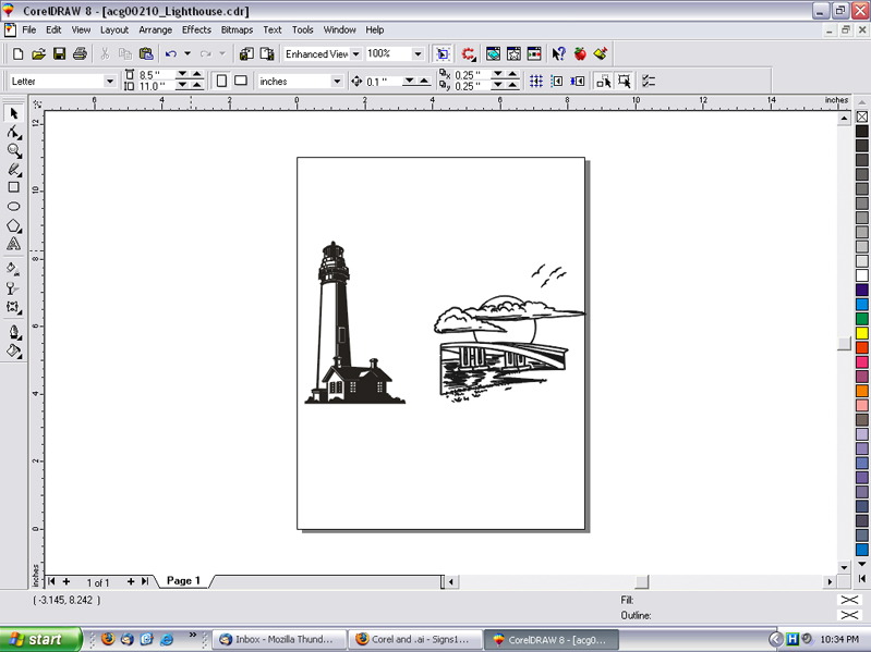

    I really hate it when incorrect information gets posted and then reinforced as if it were correct. The image below is the result of OPENING the lighthouse in CorelDRAW and manually selecting the Illustrator AI filter. The bridge scene was then IMPORTED into the already open CorelDRAW workspace using the same filter selection.
    Both files are saved as Illustrator EPS version 3.
    Your problem is most likely in allowing Corel to decide automatically what import filter to use.
