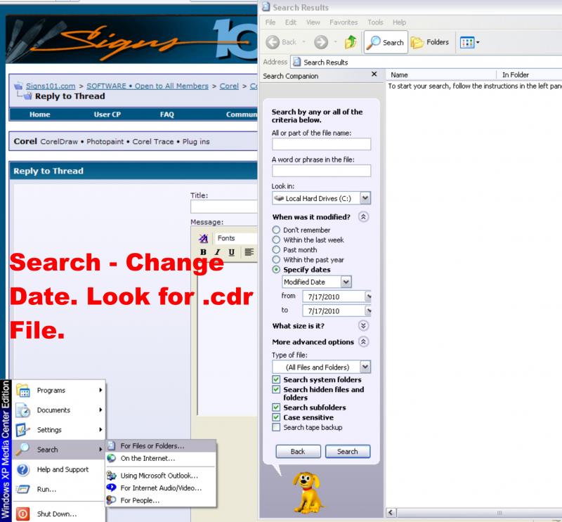

Marco
Lost & Found
It's happened to me too. I found every one as shown above.
