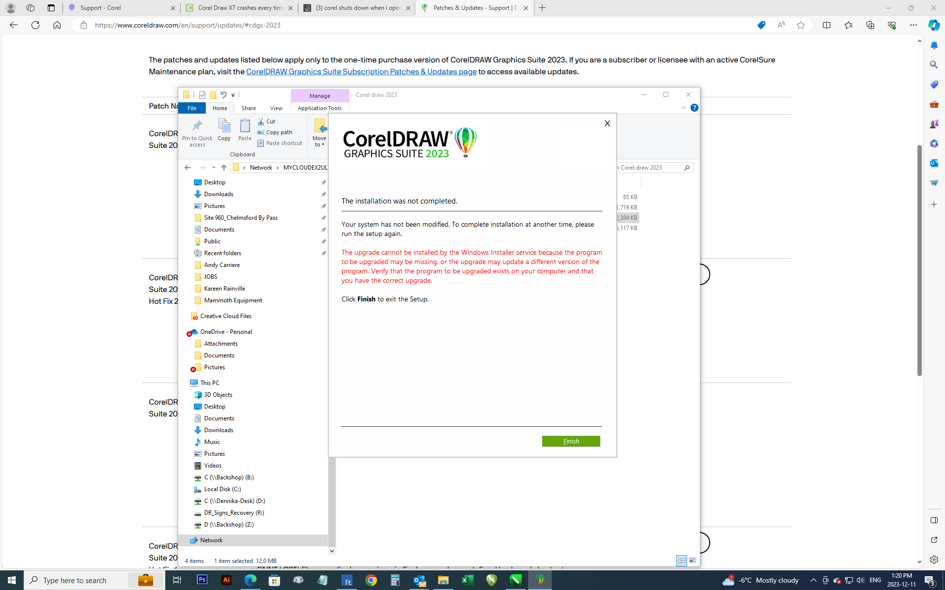

I run this Hot Fix and then I get...

Looks like maybe you have a Windows registry conflict as Windows doesn't seem to think Corel is installed on your computer. That could be the case if the software is pirated or if some of the files are corrupt. Might need to do a reinstall.
dasigndr
all programs are legit. It only affects that one file (that I can notice so far) so a complete re-install would not be necessary, IMO.
