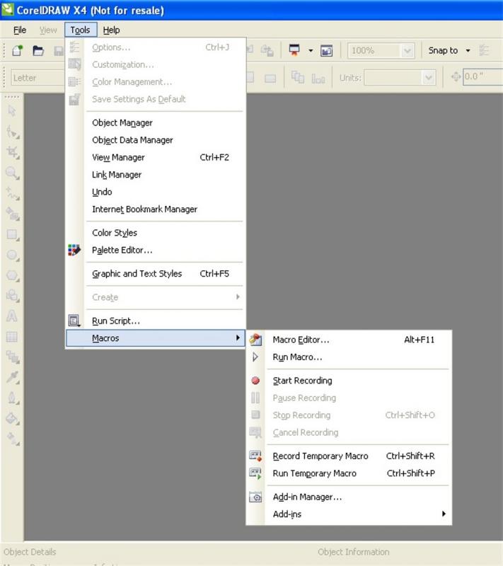

Jill are you sure the version you bought is not educational?
Do you see macros in the tools drop down?

I just went through an issue where I installed CorelDraw on a different computer. We have multiple corel discs and all are legal copies. I couldn't get cutting master to work at all. It's the full version. I tried and tried. I finally noticed something on the disc, it said "OEM" on the disc of Corel. I went and got another disc that didn't have that, installed that and it worked first time.
Cutting master doesn't like some versions of corel. I had no idea there was any difference in the OEM version and the normal version, so be aware of that.
Techman
Plug ins need the visual basic module to run the macro's.
Student versions and reduced versions do not have the visual basic module.
Jillbeans
Oops no wonder it was only $51.
I think I f'd up guys.
:doh:
Think its a demo or beta version.
