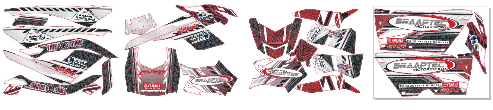

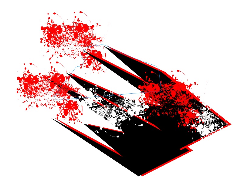

I have a designer that works with me and I do designs as well , issues is I use the powerclip a LOT , but my computer is dead slow due to the objects
im power clipping. I knew Flexi has this option but does Corel?
JakeC-Lytle
I have a designer that works with me and I do designs as well , issues is I use the powerclip a LOT , but my computer is dead slow due to the objects View attachment 133701 View attachment 133702 im power clipping. I knew Flexi has this option but does Corel?
Never really tried what you're attempting with powerclip, but I may have a work around. Use your powerclip shape and grab your contour tool. Drag a contour out past all of your graphics. Then break apart the contour and combine it with the original shape. Make sure your splatter graphics are all grouped together. Then (depending on your layering) use your shaping and do Back Minus Front or Front Minus Back. Then break apart your original path and delete your contour. Everything should be cut to shape now.

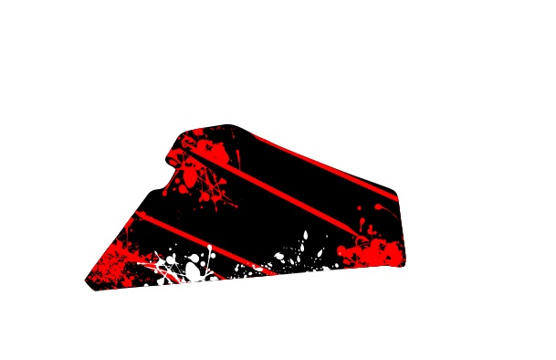

But one thing you could do is export the powerclip as an eps, then when you import it, it will no longer be a powerclip, but a group of the objects with the inside graphics all trimmed off. If you need to have a bleed to print, make that first before you export because there will no longer be an excess graphic to fill the bleed if you make it later.

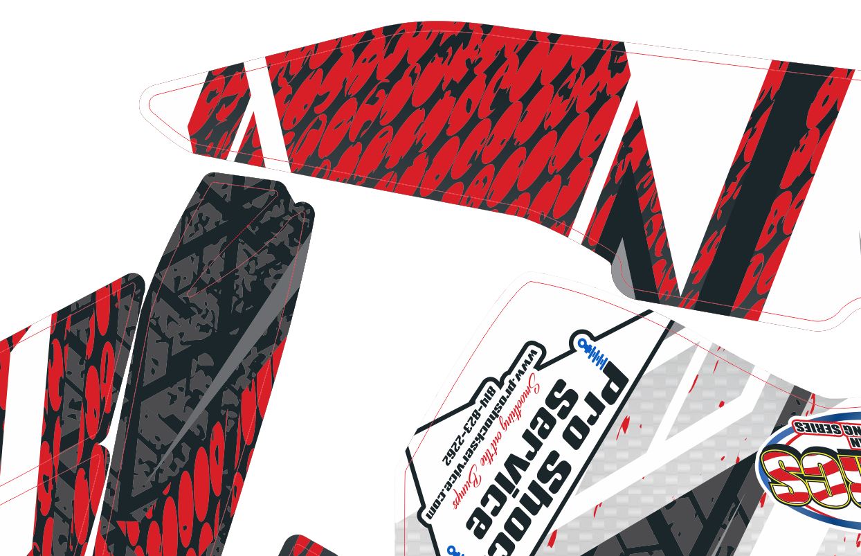

I use pink for cut line and I put a .25" bleed around my cut lines. I clip the design to the bleed.
Lately, I've been doing more complex designs so I save the original layout file in vector so I have the vector art. Next, I save a new file for printing. Here, I select everything for each portion of the kit (i.e. left side, right side, hood, or front number plate, etc.) and group it, then convert it to a bitmap. Then I powerclip that bitmap to the bleed. Once you've done that for each piece, you can convert the bleed powerclips to bitmaps also.
Seems to work a bit faster, but is defintely more steps.
