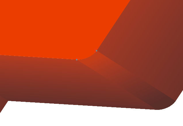

In a simple test I tried to recreate my logo and used the Extrude function to create the 3D effect of the plus symbol. However I am getting a strange effect on the rounded corners (see attached). Can someone explain tell me how to get a more natural looking image where the rounded corner doesn't appear seperated from the flat surfaces?

However, i am still having trouble with the rounded corners when extruded. The gradient fill looks much different than the straight sections (see original post). Any ideas on how to fix this?

break the extrusion apart, select just the rd corner piece and give it whatever fill you want. Maybe welding it to the other side pieces

Thanks jiarby, breaking the extrusion about and then combining the mating sections did the trick.
