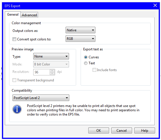

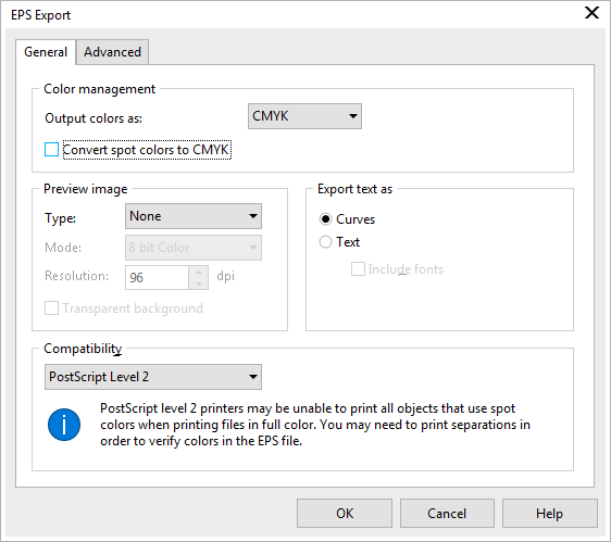

    i built a new computer and have been having issues ever since.
    went from corel x4 to corel x8 because the latest windows 10 will NOT run corel x4.
    now, whatever eps i make in corel x8 gives me a file corrupt error when bringing into roland versaworks.

    Same export settings as before?
  3. tj mach
    tj mach New Member
    6
    1
    Jan 16, 2020
    houston
    yes, same settings.
