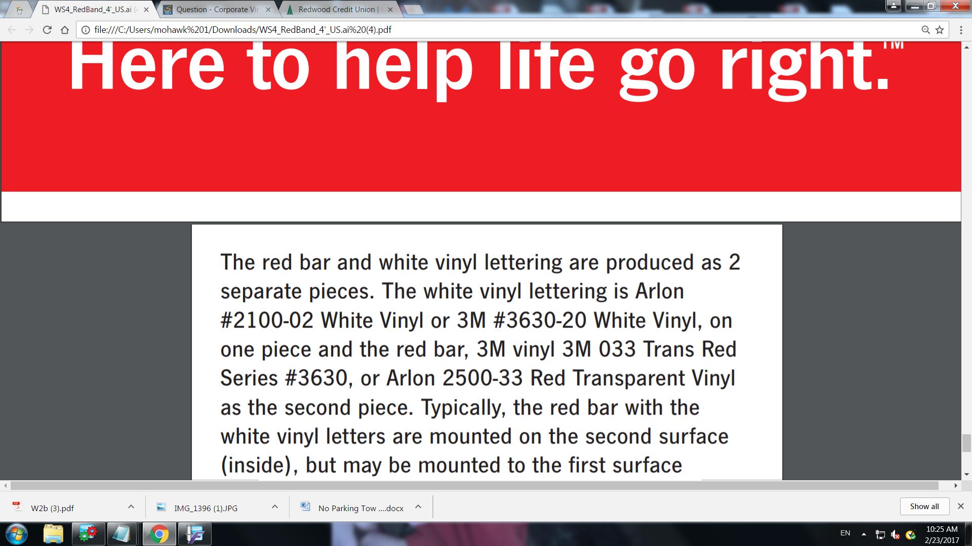

I was just handed the sign standards from 10/1/2014 and it says the vinyl is Arlon #2100-223 Peacock Red. I would rather use the 3M Warm read if possible but would rather not anger the statefarm gods.
Signchief
Here's a screen shot of the specs, like I said the info you have from 2014 is not current.

Signchief
If your customer is planning on having State Farm reimburse for the signage I would strongly suggest getting artwork approval from corporate before proceeding because if the signage is not compliant not only will State Farm not reimburse the agent but they will make the agent redo the signage. Or just do what the agent wants and maybe you'll pick up an extra buck if they are forced to redo the signage.
