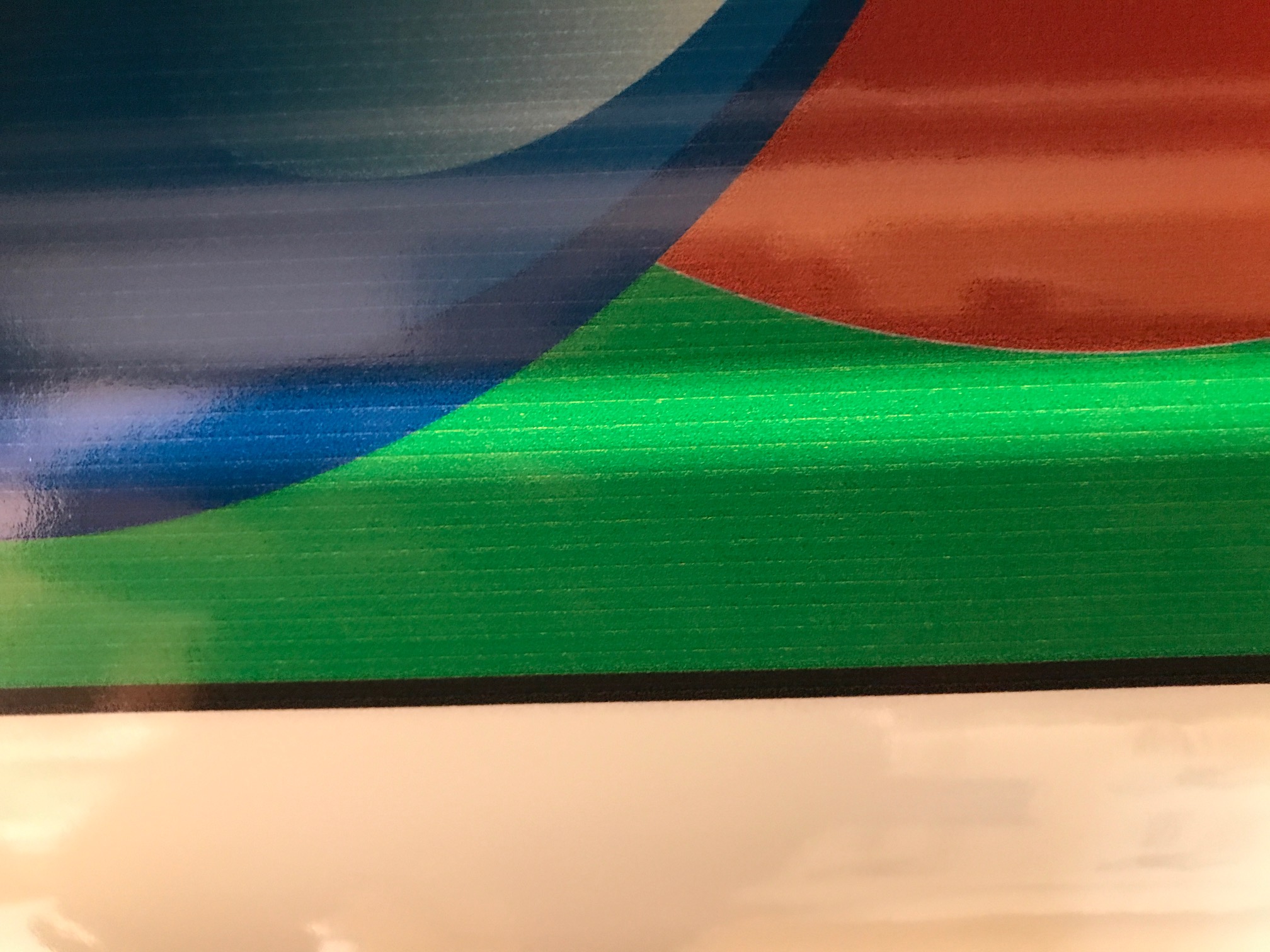

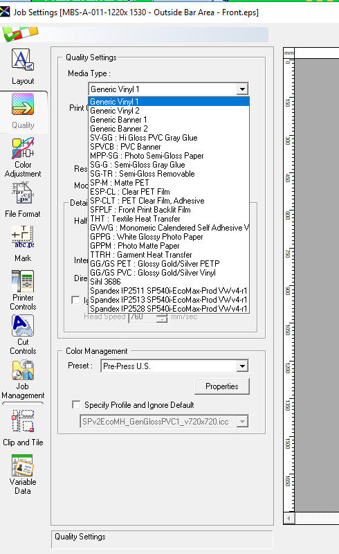

Hi can anybody help I am trying to print IP2528 with the standard profile Spandex sent me they haven't sent me a high quality one so i cant try that any help would be G8
Mysticalvibes
Hi, You seem to have banding in your print. I'd say to try cleaning then heads first. Don't think the profile is your main problem

Hi thanks for the response everything is clean and although the heads are not perfect i don't have this problem on other media

There's a setting to do with how fast the material gets fed through your machine. As far as I know it's known as "feed calibration". It's not something I know a great deal about but a bit of researching online should tell you more about it.

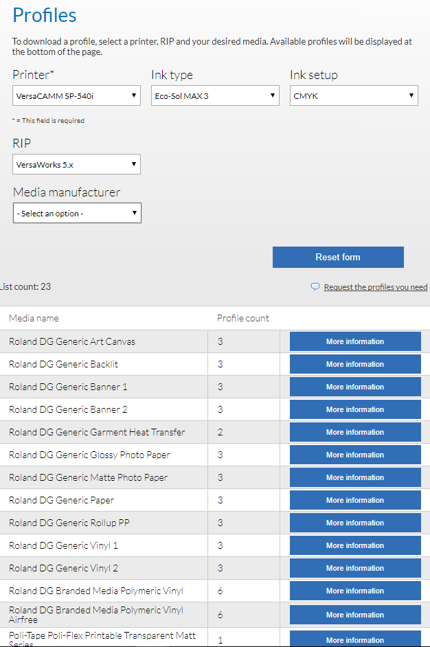

You can add more from the Roland site.

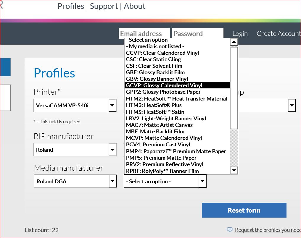

hi I have tried the uk site only give the option with max 3 ink which i dont use and it dosnt have GCPV on either i any body has the file it would be worth a try tks

Hi I have tried to get it from this page which is completely different to the Europe site but it wont let me download from there it wont even let me on it after I have logged in

Contact Roland support. There must be a problem somewhere...
