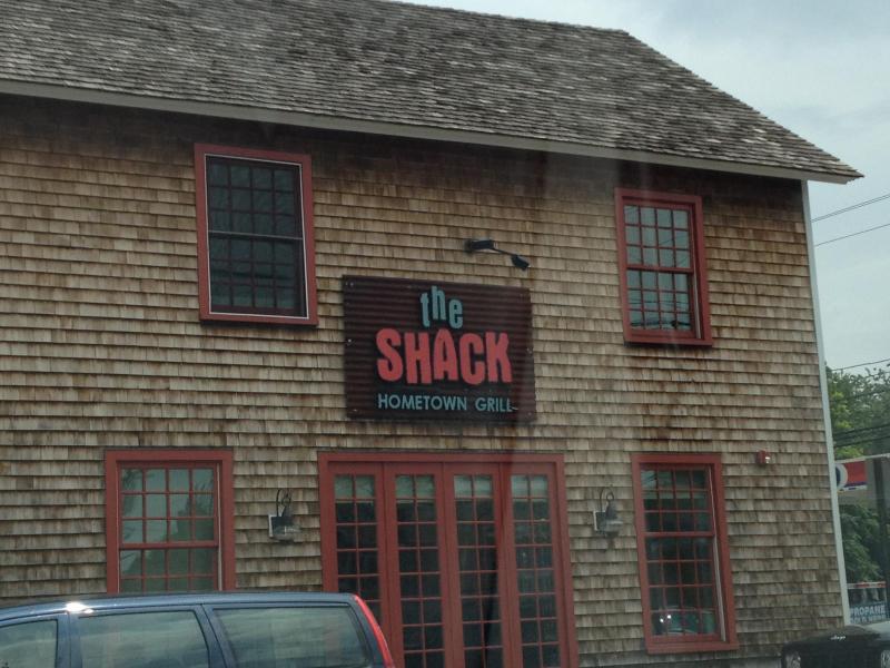

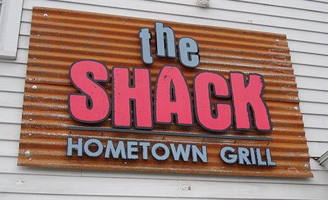

Yes.Here is a sign we made using Corten steel we had shipped from Arizona.
It rusts out really nice.and we like that a lot!
