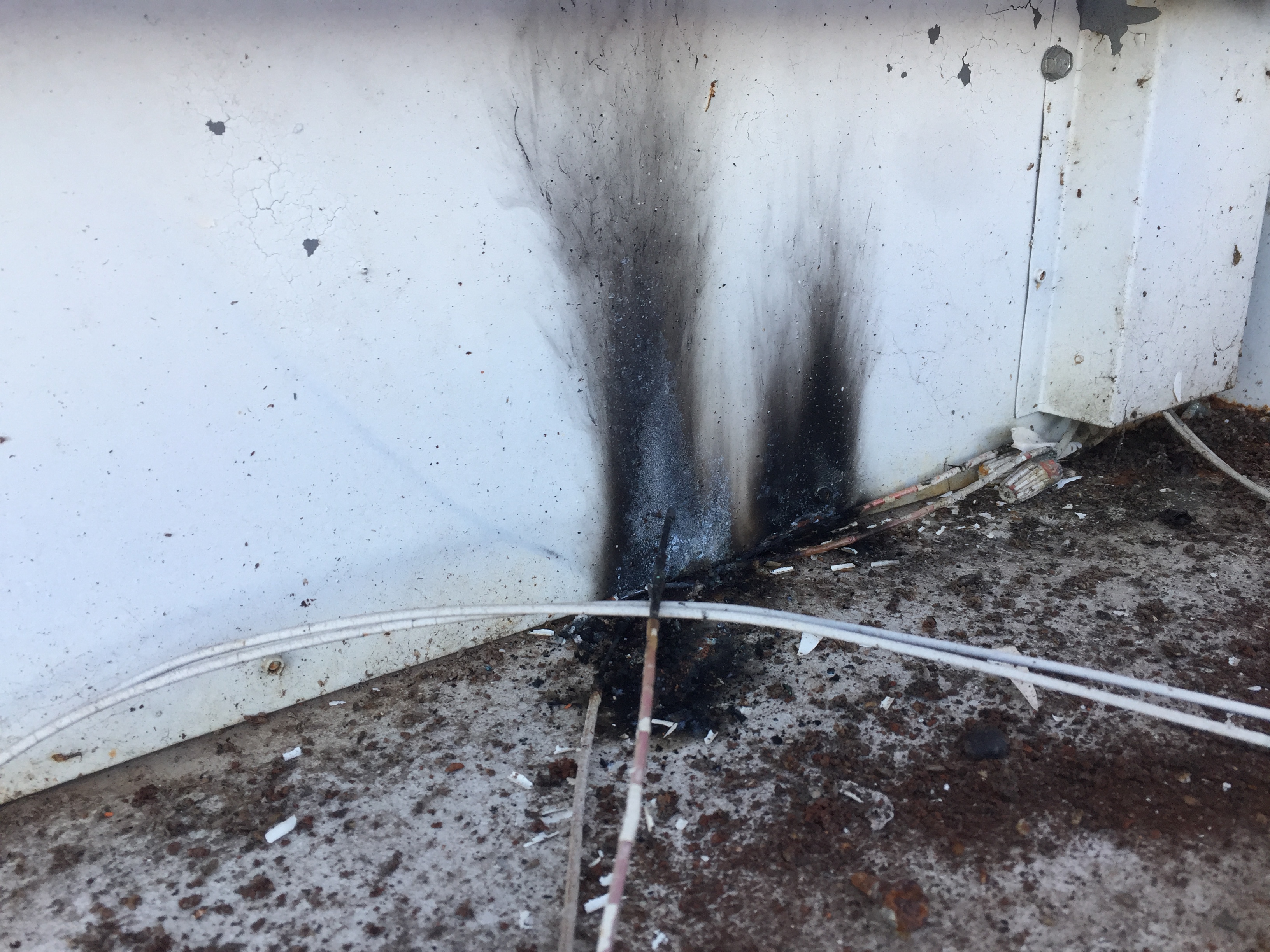

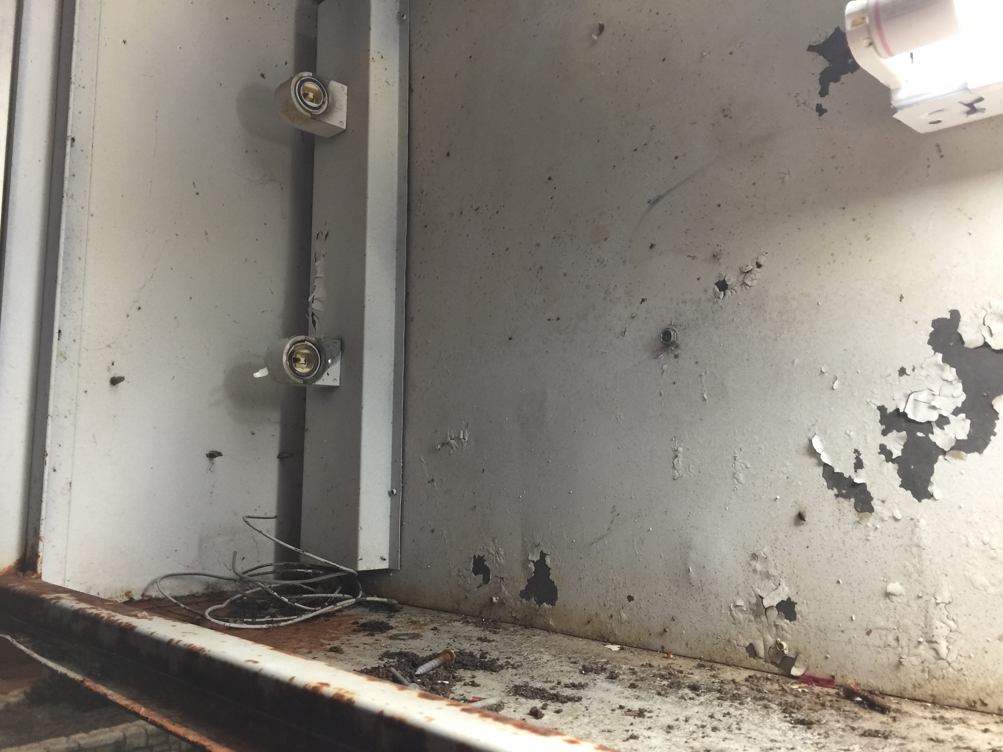

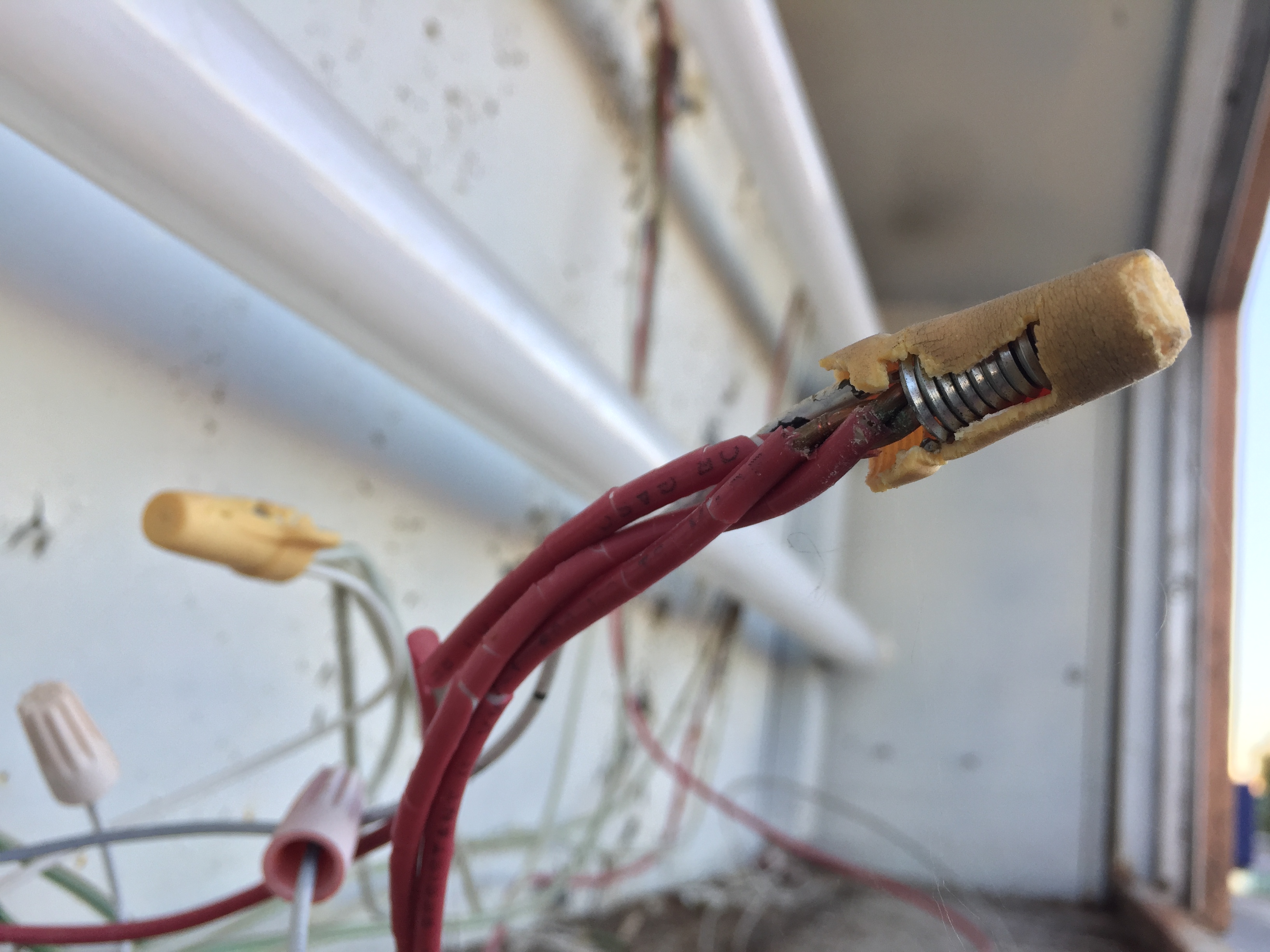

    here is an example of why recording your work is important.
    new faces were ordered for a wall cabinet.
    arrived on location opened the face and found (see image "BEFORE")
    took images (didn't show them the images... yet) and told the end customer of the issues before the new faces were installed, they didn't approve the repair cost and only authorized the faces.
    2 weeks later, get a call that we "broke" their cabinet and demanded to get fixed ASAP.
    remined them POLITELY we already told them of these issues and they only approved the faces., we would look as soon as possible.
    since we were in the area, went by to look at it later that week.
    they tried what was assumed to be a DIY fix, screwed a new fixture to the back of the cabinet and connected to the existing leads.....
    (see image AFTER 1 & AFTER 2)
    Because of the photos, and date stamps we could prove work was done AFTER we touched the cabinet. They quickly changed their stories
