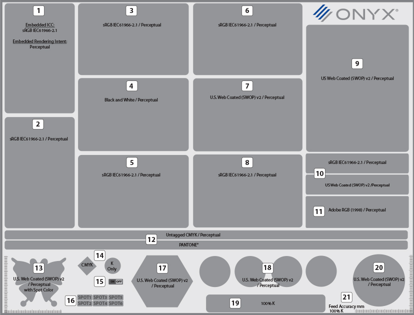

1) Yes, Onyx is capable of handling mixed input profiles. (See the attached image.) You should have the file "Onyx Quality Evaluation.pdf" in your Onyx folder(s). Notice all the intents are set to Perceptual.
2) It should be the job of in-house designers to "normalize" the elements of files destined to print. For example, make sure all the photo elements use the same working space with embedded profiles. For shops who accept files from outside, the prepress operator should be sure to again normalize anything they can. For example, if an element does not have an embedded profile, assign a profile that makes sense. Otherwise, Onyx will use the default that it is setup to use in the case of missing profiles and that may not be the best choice for the given element.

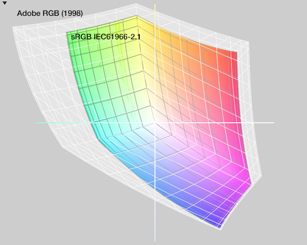

most working space profiles are very close to each other.
Except in the case of typical RGB working spaces.
That being said, if you create your own working space profile to match the gamut of your printer, you can print all day long using CMYK and hit all the vibrant colors you want.
