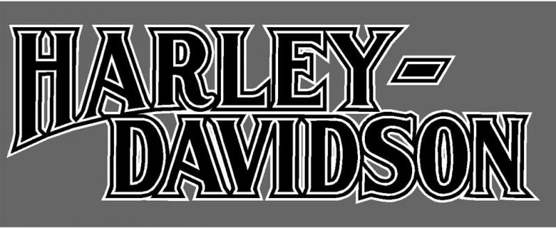

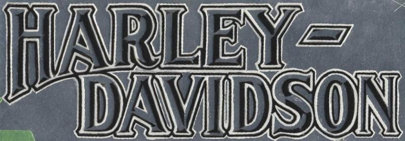

Can you confirm this? If so, will it turn into something like this?

The logo is there (look-a-like...) but w/o the bevel. I had to tweak every corner of every letters in order to get the outlines like the original. P.I.T.A. to say so...:banghead:
