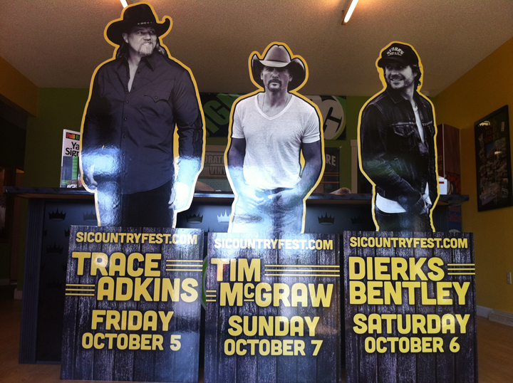

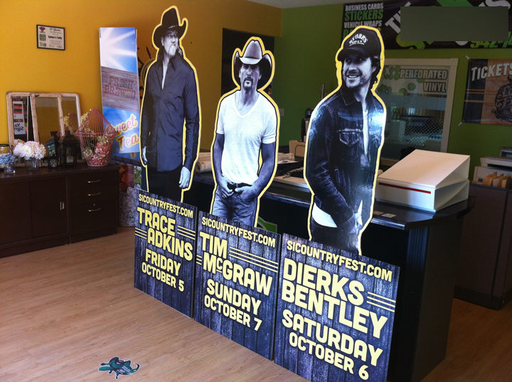

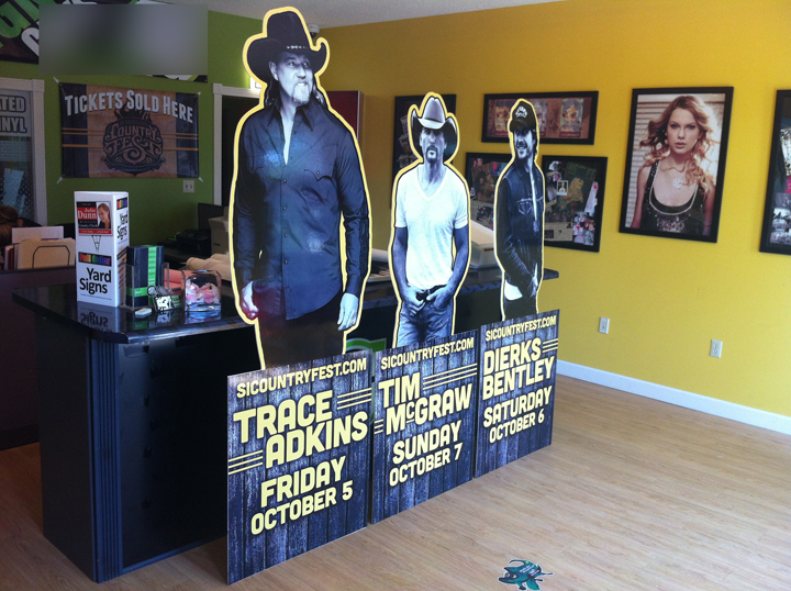

made some life size cutouts (by hand) today. I thought they turned out nice
ucmj22
I used Ultra®Mount foam core. prints on Oracal 3165 with calendered gloss laminate and cut by hand.

Those are sweet man! (the finished product I mean.....not the subjects lol)

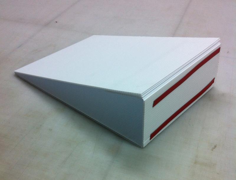

How did you make the base/stands? Got any pics?
Thanks. I couldnt get decent full body pics of all of them, so I decided to use the wood at the bottom. It gives it more stability anyway. those are life sized, and I discovered that Trace Adkins wont fit through a door with his cowboy hat on. 6'6 plus the hat. I havent attached the stands yet so the customer could transport them easier, but I just made wedges out of coroplast assembled with foam mounting tape.
