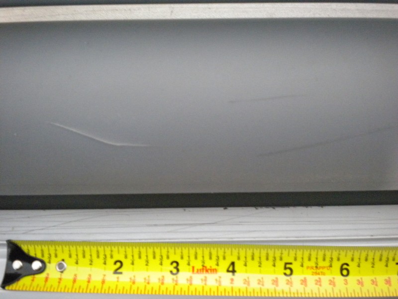

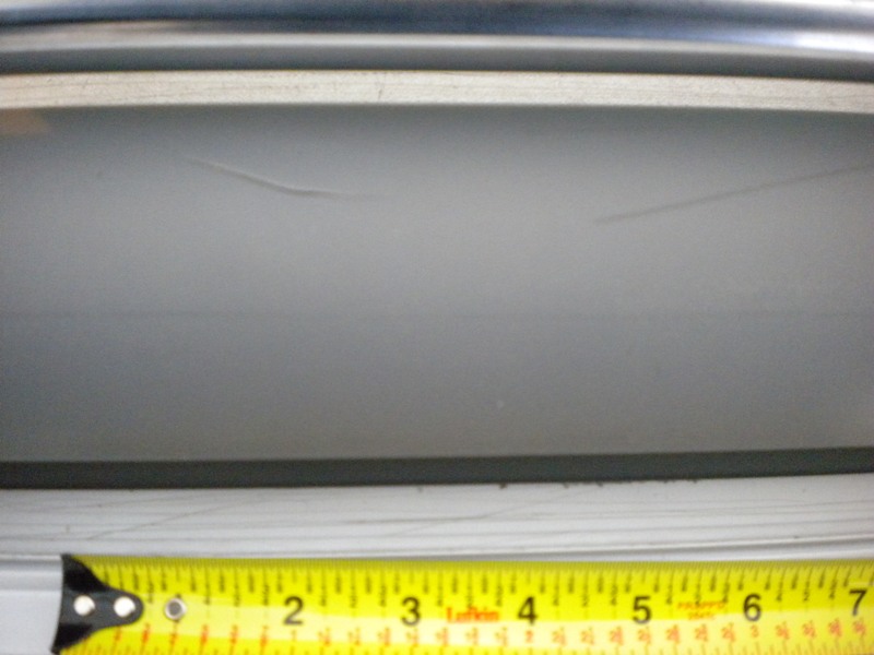

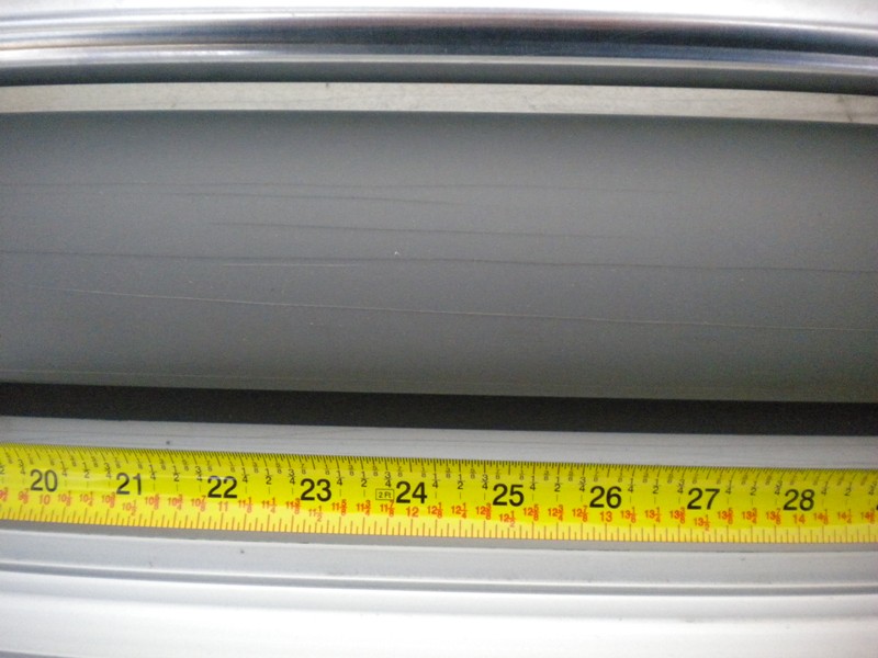

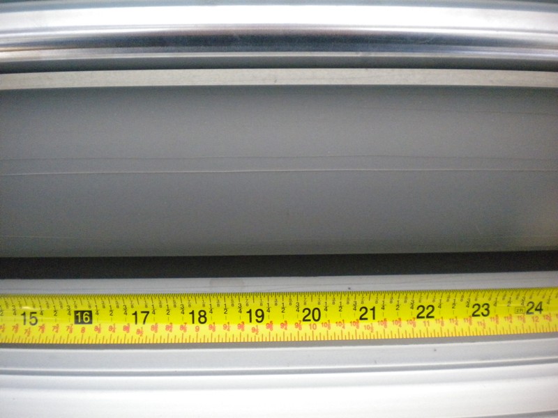

Here are some shots of the rollers that the seller claims are only scratches. These cuts are around both rollers.

Wonder where the supervision was when the employee was slicing and dicing? Do you think this guy competes on quality? "Hey Mr. Customer, I can beat anyone's price!!" :covereyes:
