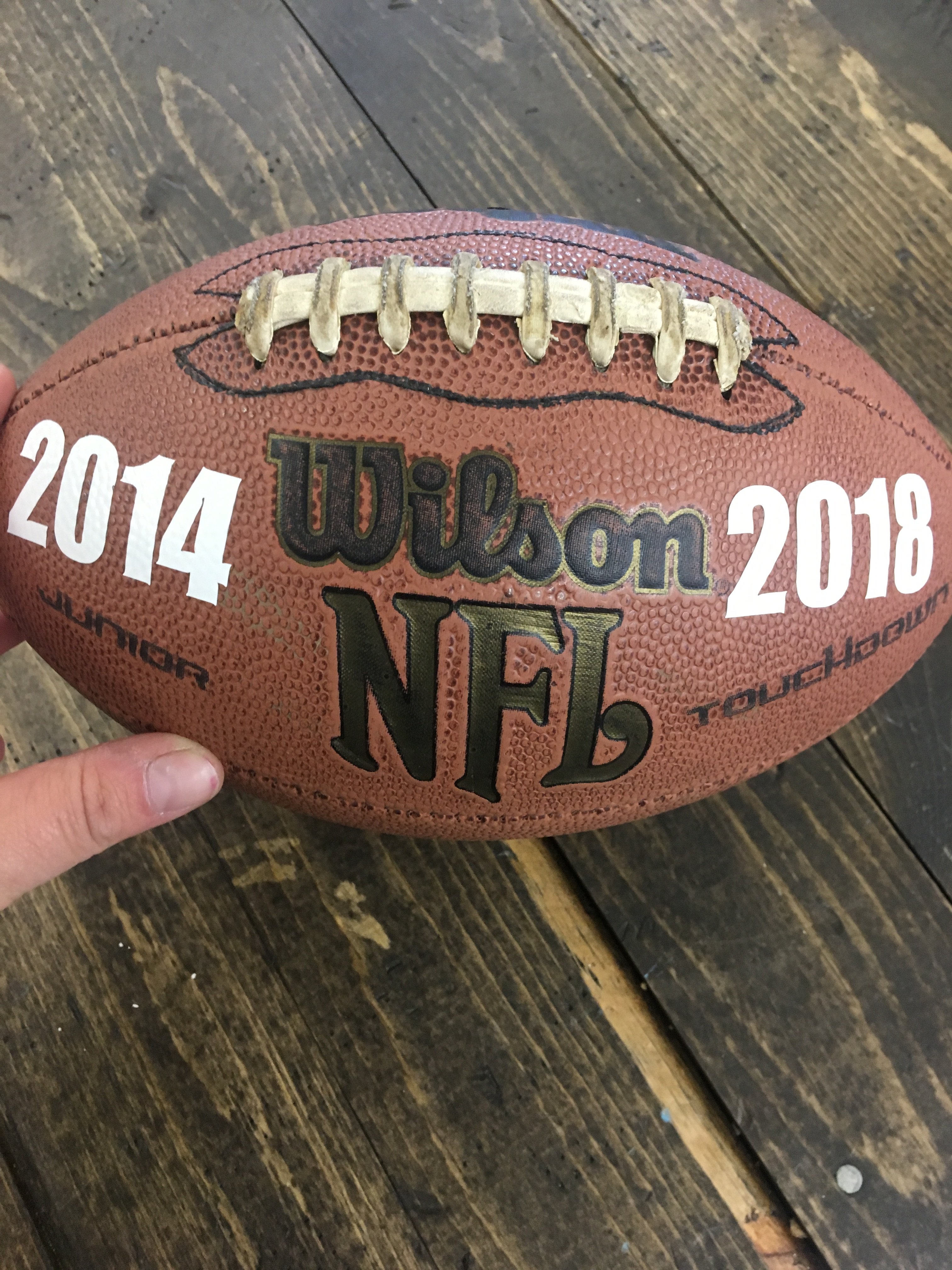

I literally JUST did this sample football for my son's coach gifts. I used Convex vinyl that I had left over from another job. Seems to be sticking very well, I did this early last week. I'll be "lettering" 4 new footballs this week. If you need a chunk of this vinyl, I have an entire roll sitting here, I could send you some vs. ordering an entire roll.
