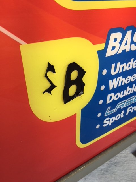

Does anyone know why this would have happened? (see attached pic) The cut vinyl prices are peeling off only after 1 month. According to customer, the transfer tape stayed over the prices for 2 weeks once they received it until they pulled it off right before grand opening. The sign is a 2nd surface backlit on acrylic, and the prices are cut black vinyl (no laminate) on top of the plexi (so we can change prices when needed). What I find really odd... there are 2 signs, and the 2nd sign is perfectly fine. I've been doing this process for a good year now, this is the first time I've seen this happen so quickly. Someone please educate me so I can avoid this in the future. Thanks.

its hard to tell from the picture, but it could be they was applied to a dirty surface or got way to warm

Surface was cleaned with alcohol and dried before applying, I did that myself before it went out of the shop. It's possible it got too warm sitting around on site before they installed the sign.

(1) It's Avery. (2) It's calendared. If it's facing the sun full time, it's going to shrink and pull, just like that.

Even though it's calendared, it shouldn't have happened that fast.
So you applied it, didn't pull the transfer, they installed the sign face and removed the transfer two weeks later?

A little weird that it looks like that, AFTER they pulled the transfer... if it's peeling that bad I'd guess the transfer would have pulled it off. I guess it's possible direct sun/heat coulda shrank it enough... looks like adhesive outline where it shrank is visible on the yellow.

A couple of guesses based on the fact that looks like a sign for a car wash:
1. Someone decided to spiff up that sign before your installation using a product with hydrophobic silicone polymer,
like what's in rain-x... we had a vehicle wind shield job years ago that we re-did a couple time... every time cleaning the window
real well with alcohol... and the vinyl still wouldn't stay on very long, due to the customer using rain-x
2. Someone took a pressure washer to it.

No way that happened without some help. I have black calendared vinyl out there in the hot Florida sun using the same process (although it is Oracal) and that is not the sun making it peel. My guess is pressure washed or sprayed with some type of cleaner that ate into the adhesion from the edges.

Wow, lots of folks hate Avery here. Good to know, I'll steer clear of it in the future. Some of you said that it looks like it was pressure washed. That would be my guess as well, since it's at a carwash and the install crew probably wanted to clean up the sign. I'm sure it loosened the edges, then the sun did the rest and shrunk it. Thanks everyone for your advice, I've certainly learned a few things here.

I have a feeling that the sign sat around onsite for 2 weeks, then they finally installed it and peeled the transfer tape off then. I also have a feeling that they went back with a high pressure sprayer and tried to clean it up before grand opening. Then after a couple days of hot hot sun beating on it, it shriveled up. .
Just make new ones and let them fix it. You'll never find out who or how it was abused. Most likely, it had some help, as mentioned. That kinda stuff does not happen in a week or two or month.
