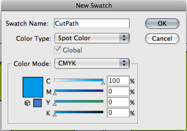

The swatch can be anything. Mine is 50% cyan. When you export it as an eps file the color name "CutContour" or "CutPath" is exported. When it sees that name, it will ignore the color and recognize it a Cut Path.

please look at the attached pics.... all of these need to be right for it to show up. It is color independent as long as it is a CMYK spot color.

CutContour is also acceptable as a swatch name...
