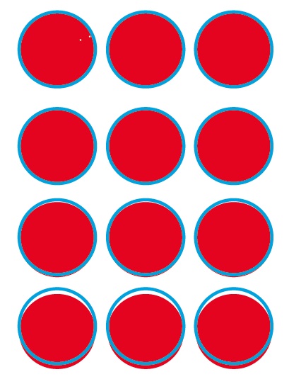

My cutpath is off at the "bottom" of the sheet in colorip. Its like 8x14 stickers. (All same, duplicated in illustrator). Its kinda weird because it shows correct at the top and as i wrote, all the stickers are exactly the same with exactly the same cutpath...
Any1 know why? :thankyou:
EDIT: aaargh... same problem even if i reduce the print to 40 stickers. getting all weird at the bottom.
zm71
i made a pic in illustrator to show how it looks in colorip, and yes, the sp300 will cut as shown.

really? the printer/cutter is cutting exactly as shown, the only problem is that colorip is showing incorrect... sounds like software problem to me, but im new to this... ur prob right.

You have to excuse me, i really dont understand how that can impact the preview cutpath in colorip. I would understand if the cutter misscut the material but i really dont understand how the preview could cause this. I can turn printer OFF and it will still preview incorrect.

The Roland cuts perfectly, it cuts the lines dead on, its the ripper that shows the lines in the wrong position which makes the Roland cut them in the wrong position.
.EPS File - Lines in perfect condition
Colorip - Lines out of alignment
SP-300 - Cuts the lines as per ripper perfectly but because the ripper is out the lines are out.
Must be a software issue.... must be.... :frustrated:
