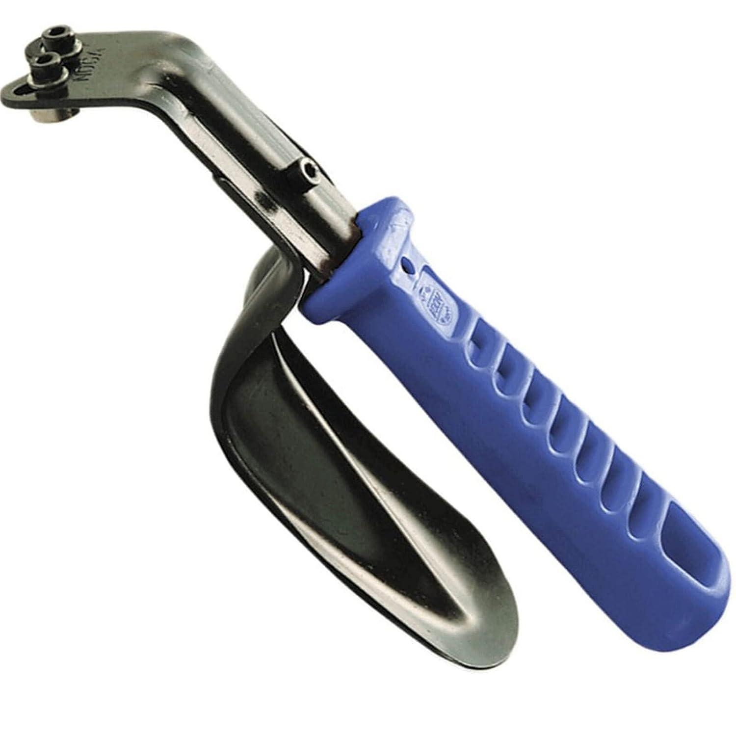

We use one of these when we rip aluminum blanks with our table saw. Low-tech, low cost, but one or two swipes and the edges are clean.

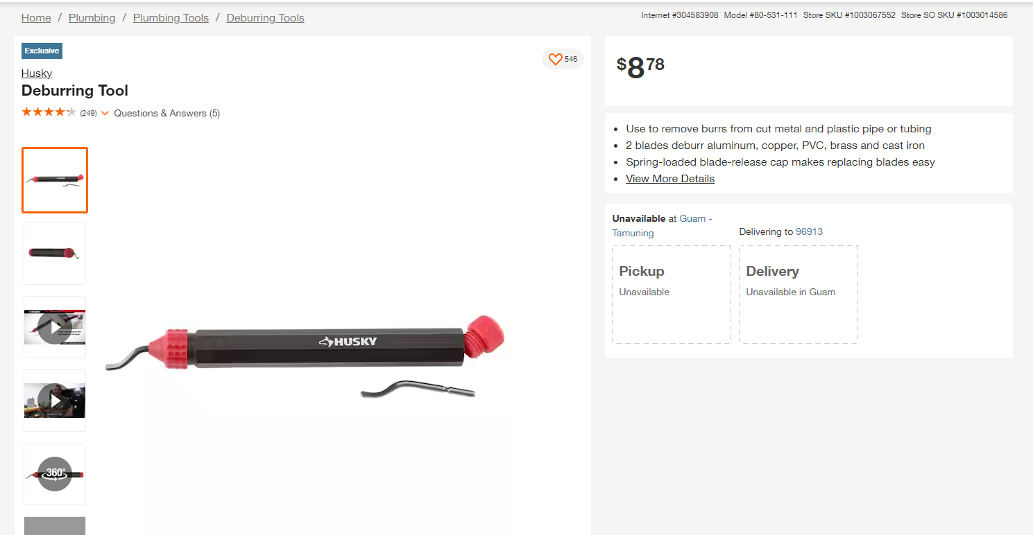

Get a tool especially for deburring the edges of sheet metal. It'll only take a few seconds to use compared to sand paper. The other style deburring tools are primarily designed for deburring holes, and they usually dig in on the edges of sheet stock.

Deburring tool now on my shopping list. Good for smoothing the edges of ACM also which often gets a sharp edge after cutting.

I've been using the single-edged one from the time I was in a friend's glass shop and watched them ripping 10ft long aluminum extrusions on a table saw - then running the deburring tool down the cut edges in single passes.
With the burs gone, I could slide my thumb down the edge like it was a smooth factory edge (no blood).
I didn't know about the double-sided tool, looks like it would be worth a try.
JB
Ordered! Thanks for the link!

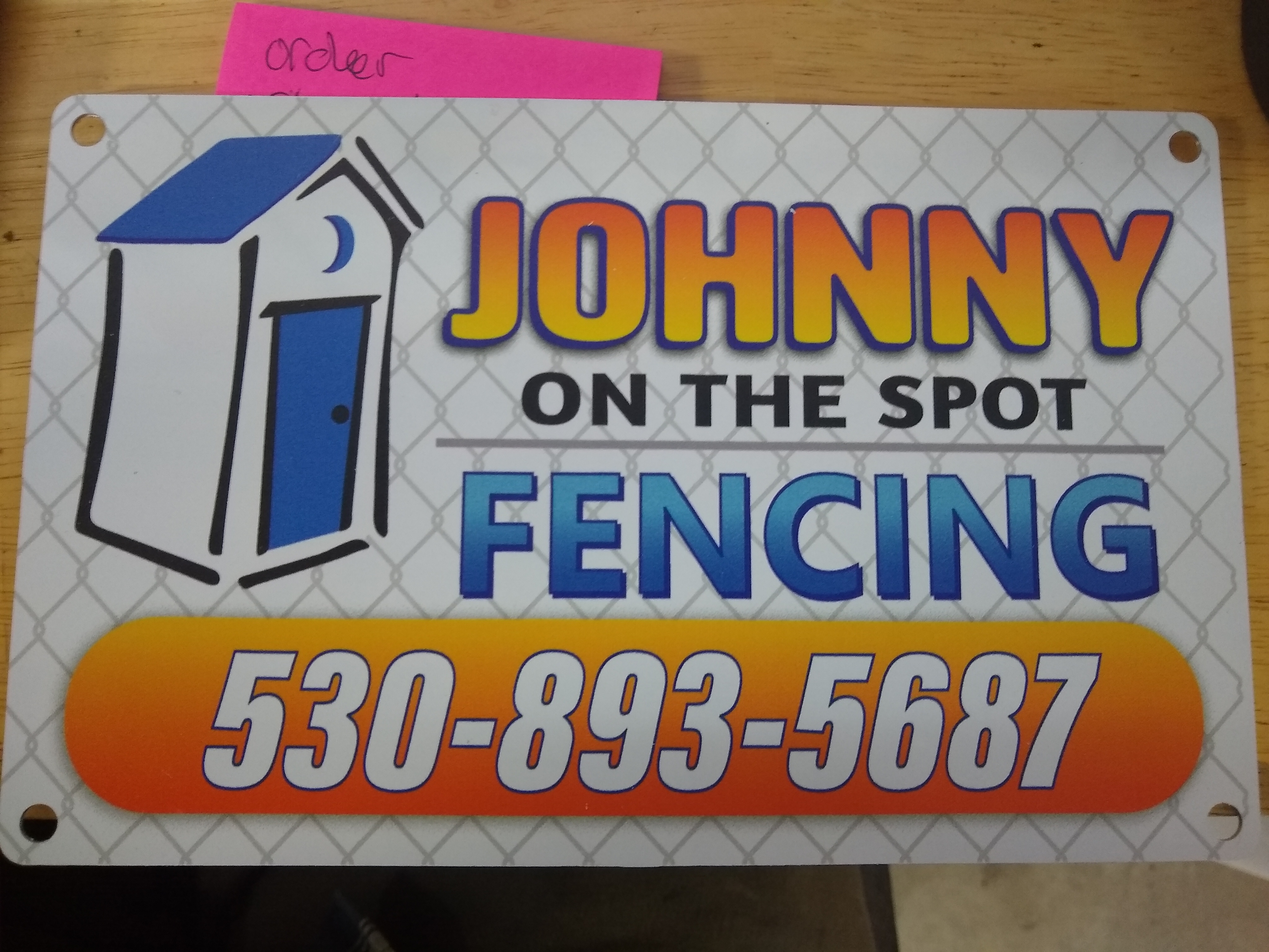

EDIT: Posted this on another unrelated thread and just realized it can show you what you should expect.
There was absolutely no finishing of those signs(other than the bridges). All edges were clean and smooth.
