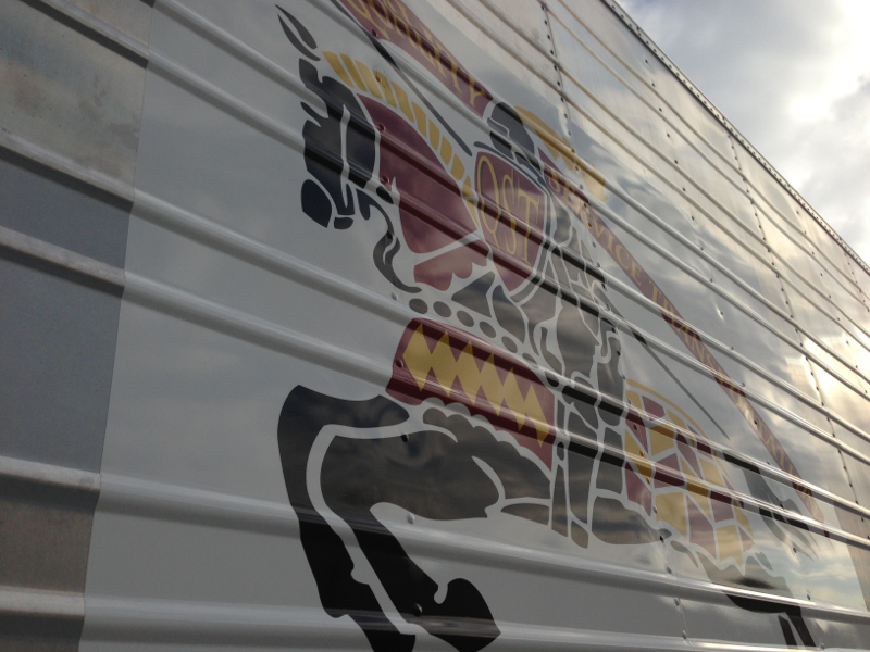

1005sc ezrs, no primer, lets see how long it last

As long as you didn't tent that and jam it in it should be fine. I've installed heaps of regular old A9 over corrugations like that w/out incident just by laying it all in.

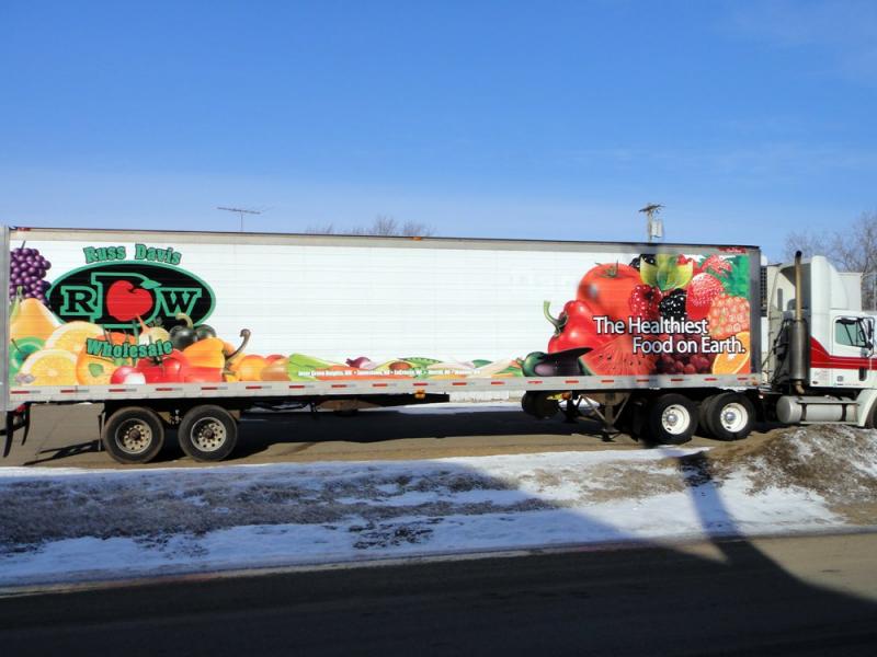

I have semi trailer skinz with ez on the road for over 3 years here in MN with the road salt, etc... As long as you cut the rivets and the seams in the trailers you won't have any issues. The trailers I do are ALL refrigerated so they condensate. Condensation needs weep holes. The trailers I do also get steam washed each night when they return from the road. So that is 1095 washing as they are pulled 7 nights a week. AND I tent and heat. The corrugations are subtle enough to know have issues. Period.
