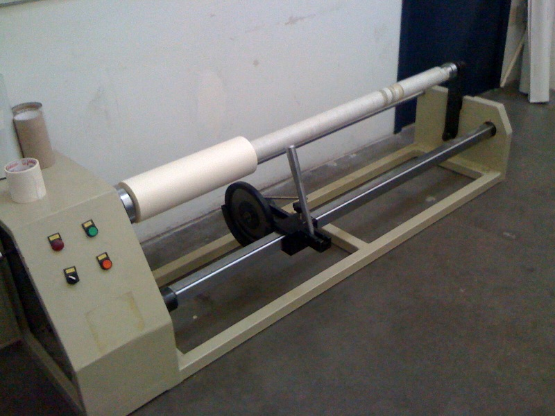

Cutting or Slitting rolls of vinyl
I have a table top pull through slitter that Ronan Tools used to make that can convert 30" or smaller rolls into narrower rolls. You can make one like it with some pvc pipe and exacto knives if you are creative enough.
I also have two large commercial slitters that do the entire roll at one time. Both create nice clean edges which is important for certain applications. If you are going to vector cut the roll then a clean edge is not really needed and you can use a band saw. I have a picture of my big slitter at http://rollslitting.com . Comes in handy for making small rolls from big ones.
