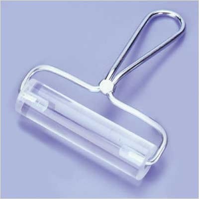

I have taken to doing it this way as well, as using the saw leaves a mess. Sometimes when scoring it the edge after bending can be a little lifted, so I saw that my screen printer had this clear acrylic roller, sort of like a 3" paint roller. I have no idea of what it's real use is, but I roll it along the edges and it flattens it back down, which is great as when you laminate vinyl to the aluminum, it can be obvious that it rises on the edges.
Basically, that's a brayer. It used mostly for moving inks and things around usually for offset, but we have two or three of them for various uses. I never thought of using it for your needs as I would think it would damage the roller, much as a sharp surface going through a laminator.
most brayers I have seen are soft rubber - the one gabba posted looks to be hard acrylic
