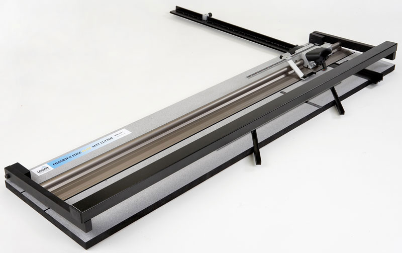

I use a 3M photo frame mat board cutter for projects just like this. It works extremely well, and you can knock them out without any thinking because material is always positioned against a stop.
If it were me, I'd use the mat cutter for cutting longitudinal strips and then use a cutting board with a stop for cross-cuts.

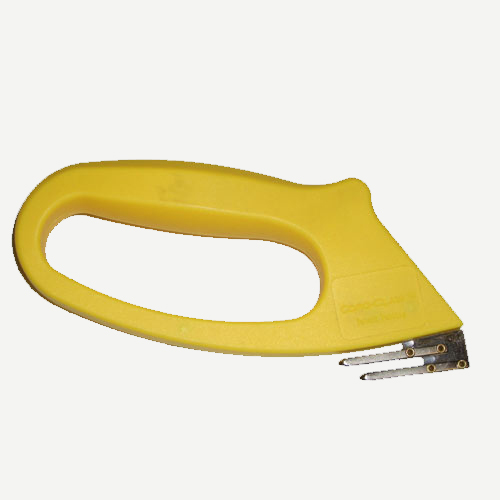

We use The Fletcher FSC multi-substrate cutter for cutting against the flutes
and the corro claw for cutting along the flutes
