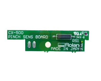

  7. ismael36
    ismael36 New Member
    3
    Aug 27, 2013
    thank you very much for everything, in Spain the cost is 89 € but I think I'll buy in Brussels that the cost is 48 €, can you tell me if the photo sensor?
    thanks, really

  8. FatCat
    FatCat Very Active Member
    1,861
    102
    63
    Feb 12, 2007
    Columbus, Ohio
    Yes, that looks like the one - it attaches to the back of the cutting head.
