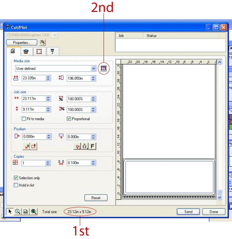

check your cut size(1) against what your cut area is. You can have the machine self adjust to actual cutting width by clicking here(2)

you either have it rotated in the wrong direction or the page is bigger than the cutting area..
