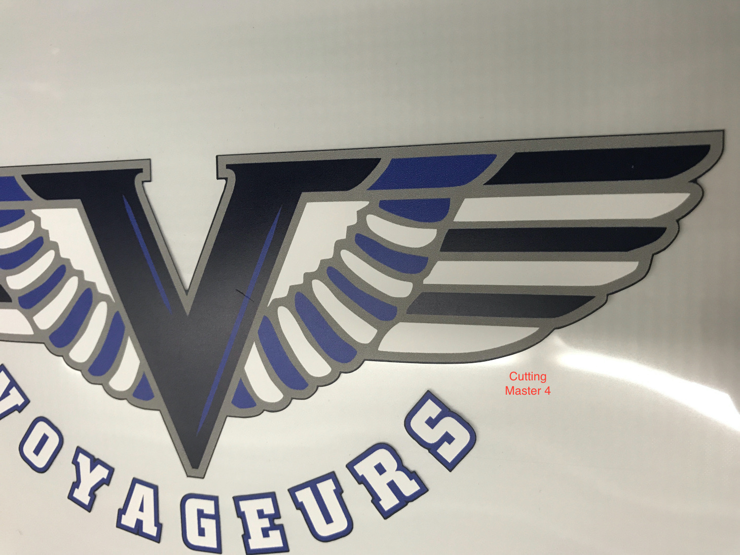

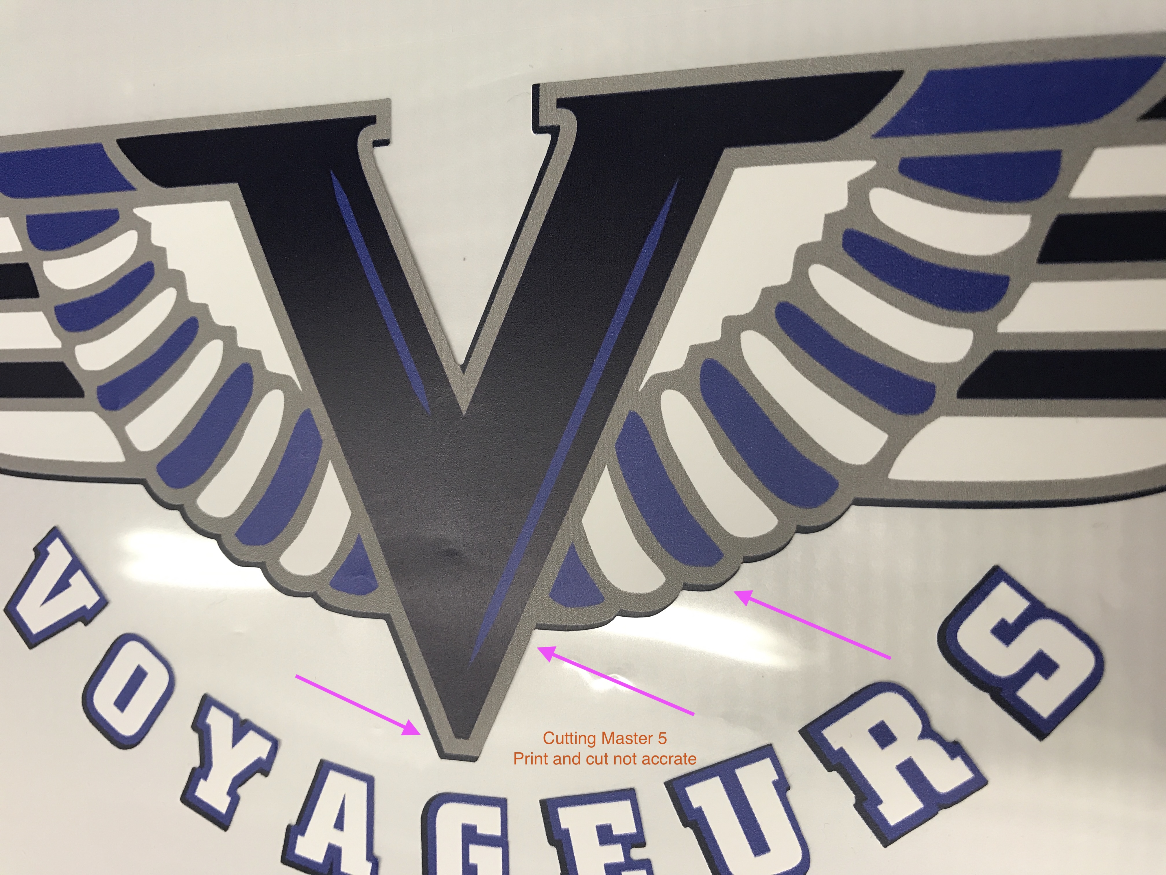

I've just installed Cutting Master 5 but my cutting job is not accurated and cutting always offset. I don't think is Cutting hardware because with CM4 all job is perfect.
Any suggestion ?

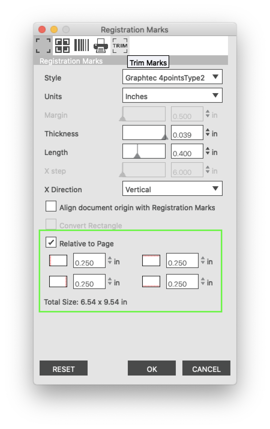

In the CM5, you must have to create the registers relative to page.
With version 4, it was in relation to the artwork work fine.

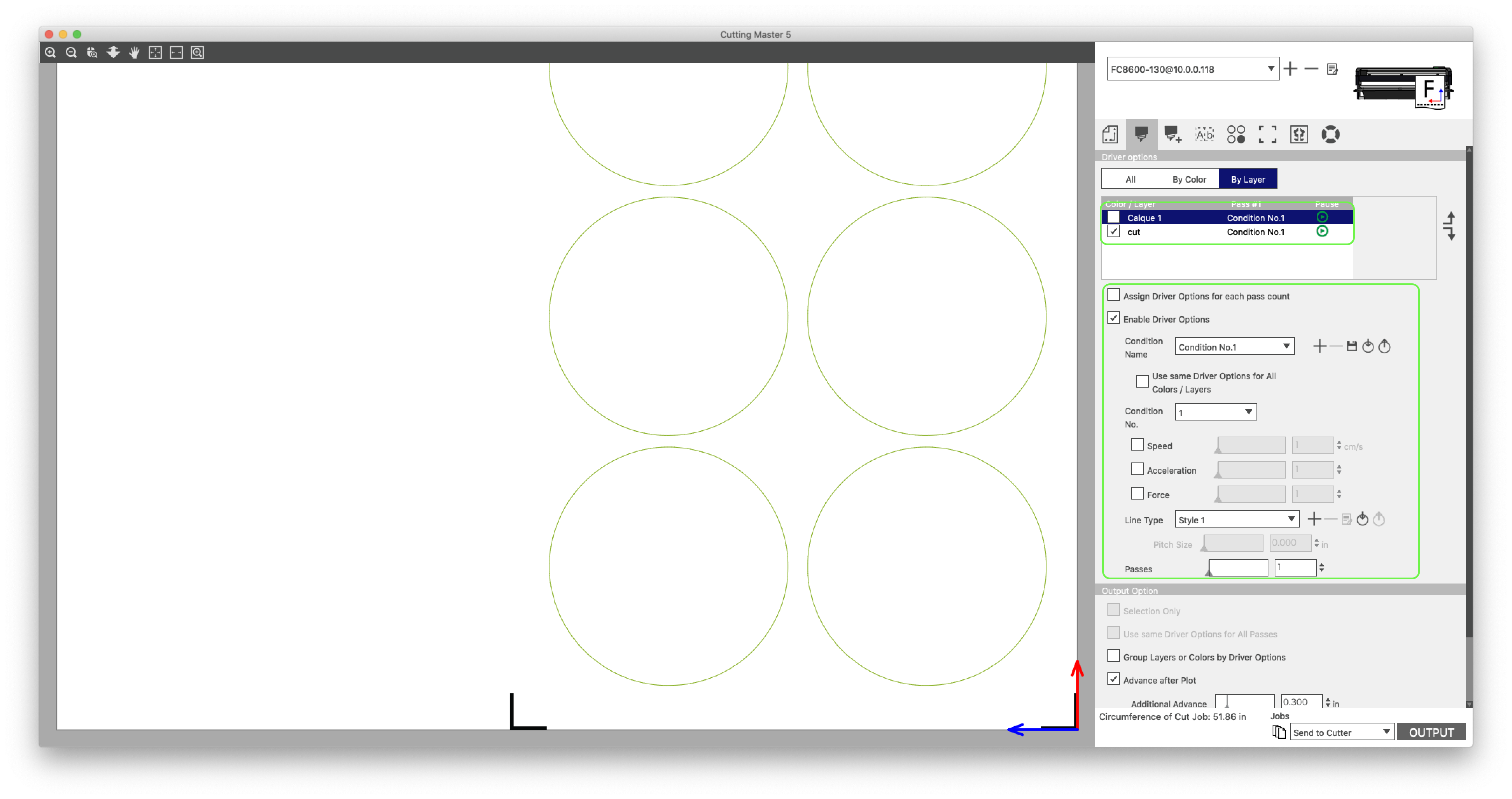

Also I think it's very important to work by layers but not with option ALL.
