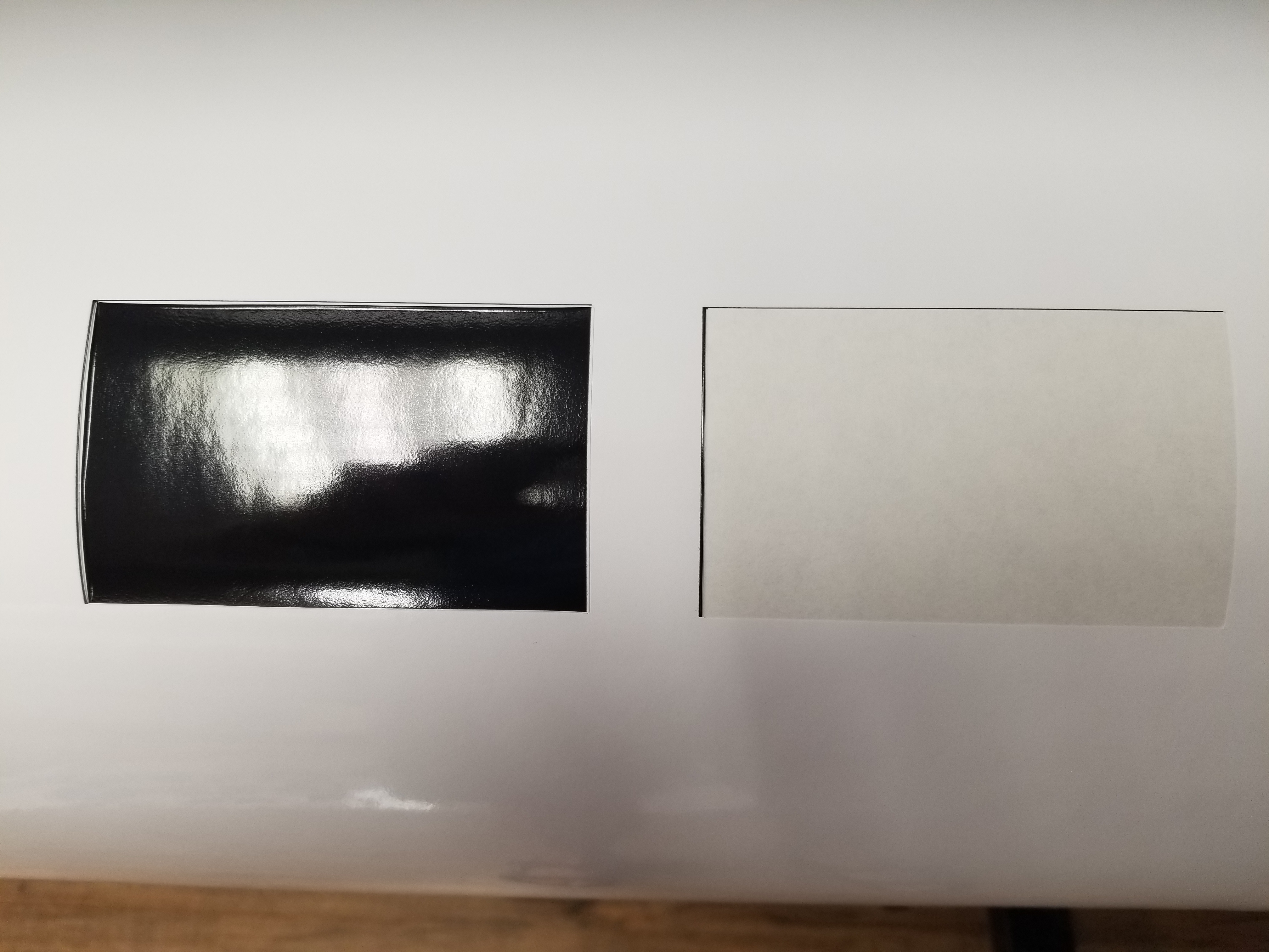

I use Rasterlink in Coreldraw 19 and just recently had my cutting off a wee bit at the bottom of the decal (cutting off top and leaving white on bottom) of about 1 mm, as well as to the left. I started adjusting the X and Y offsets and nothing changed so I really changed them higher and now it is worse than ever. I changed the X and Y offset settings back to 0 but it didn't change one bit -- now I am stuck with this cutting. I must be missing a step somewhere .....
I have a Mimaki CJV150-130
I do use registration marks when cutting all my stuff -- is there a way to convert the You Tube video to english -- video isn't very clear and I don't know the language he is using

You can run the same alignment from Rasterlink and tell it to use crop marks. That should bring it back into alignment.
Got it thanks -- helps when a guy figures out the math -- using .002 instead of 0.200 makes a huge difference lol. Was wondering why it didn't look like it was changing at all when cutting different settings
