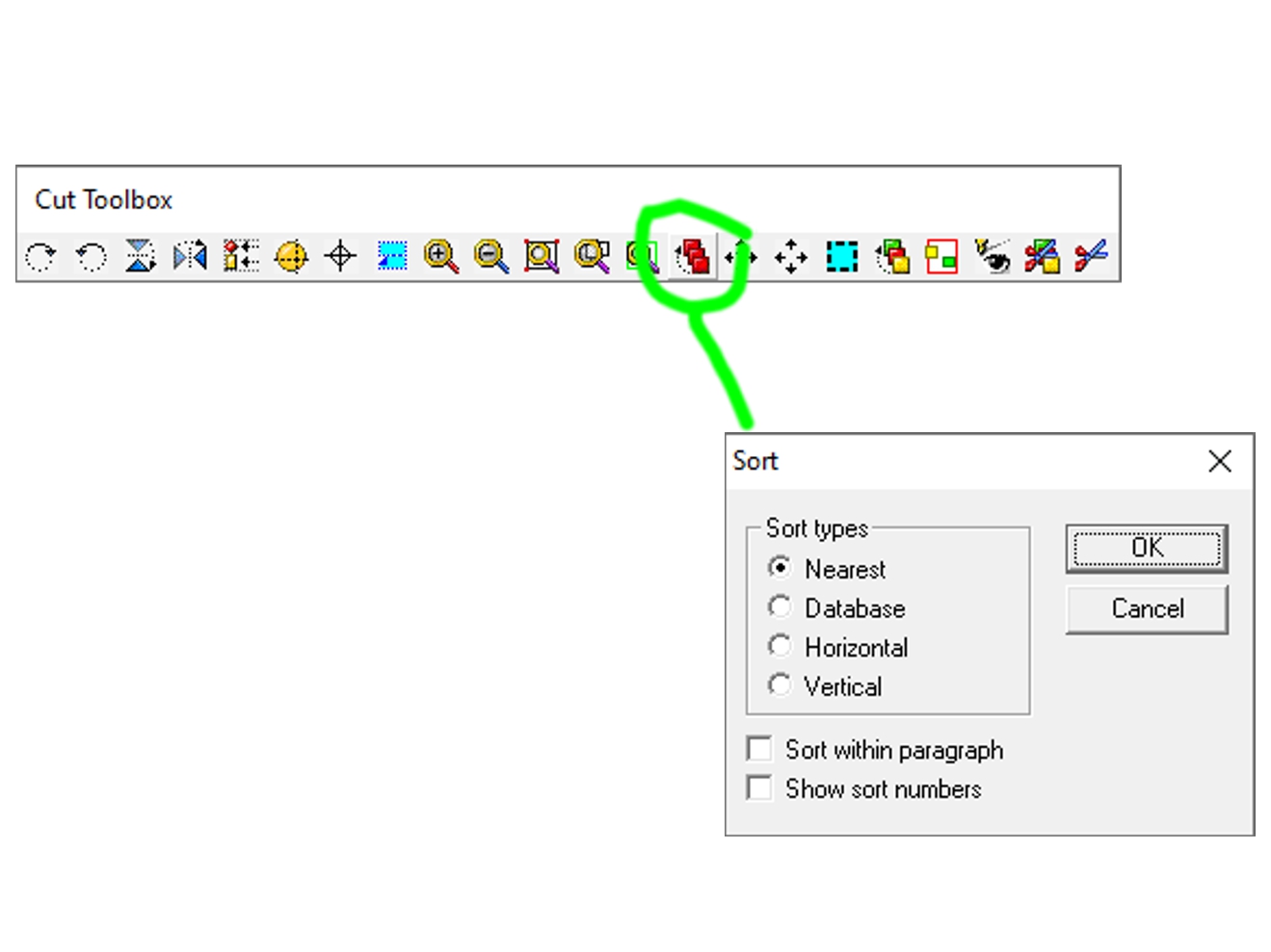

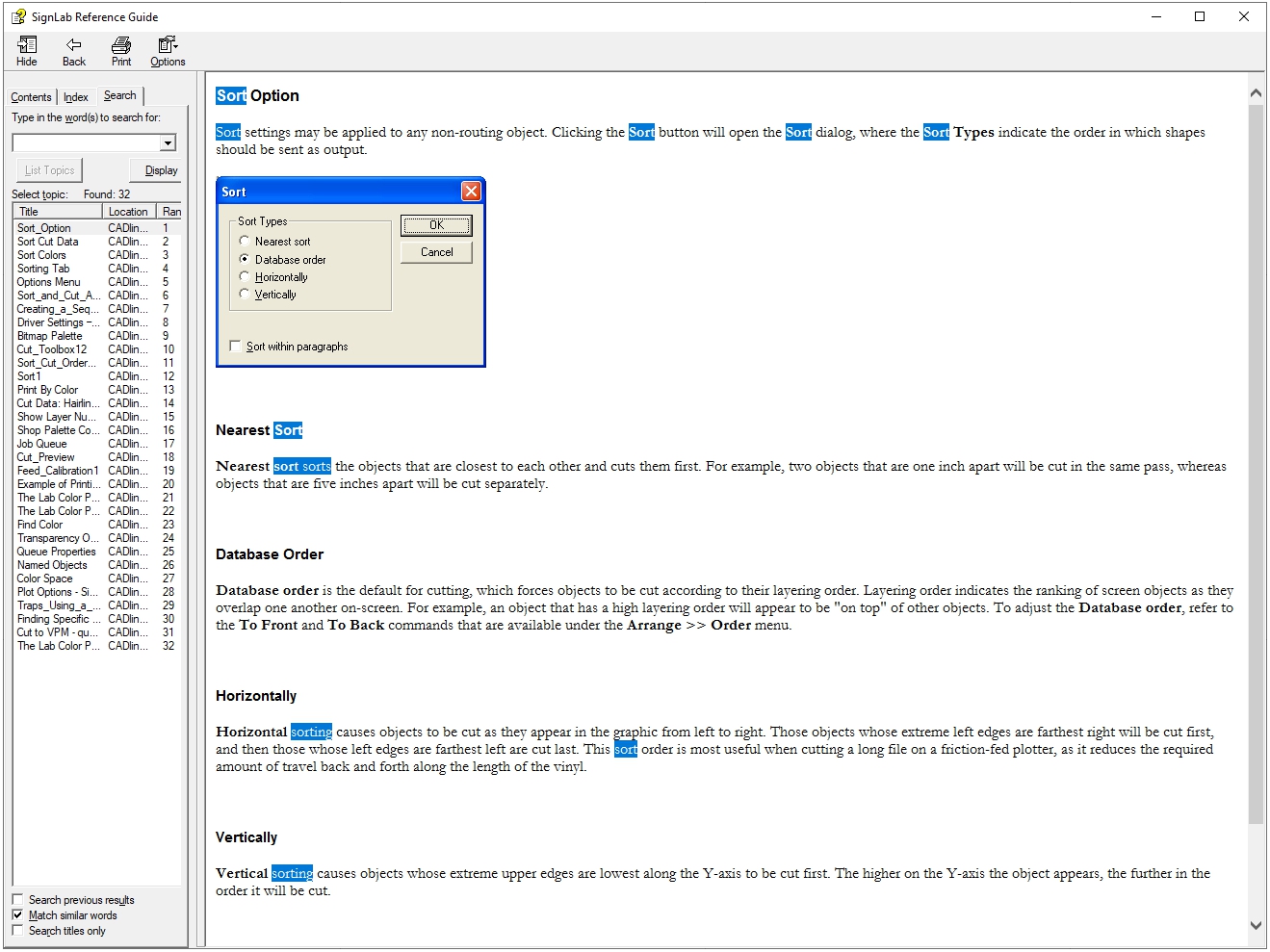

    Select your items on screen, then hit cut icon, cut toolbox opens up. In there is sort options. Also in toolbox is sort by color. Our graphtec plotter also has a page sort option others may have that as well.
