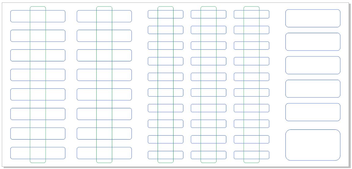

What kind of "tray are you looking for? Something cut all the way through or something routed part of the way through? Either way it is a simple line drawing that is sent to the Zund machine and then in the Zund software you can apply a hatch fill or island fill. I attached a tray i did to fit a tool box to hold the knives and router bits for our Zund.
