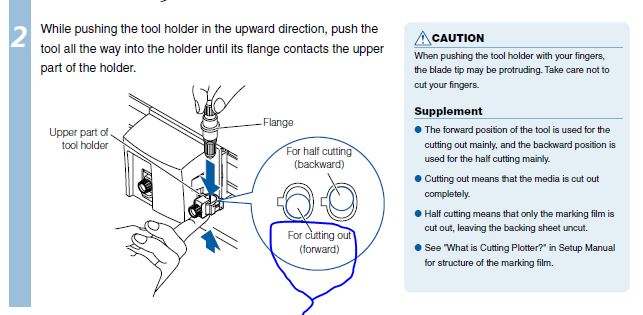

I found this part of the manual that shows where to place the blade for cutting through the backing paper of the media but when I read the registration marks of my print it is off by about 1/4" and that appears to be the difference of the center of the tool from the back position to the front position. Is there a way to tell the Graphtec it is in the front position. I'm Printing from Onyx 10.2 and Using Cut Server to send my cut files to the Graphtec.

Now I don't know what havok Onyx might visit on this process (we use Cutting Master) but the instructions for telling the plotter where you've got the blade physically installed into the machine are on page 2-32 of that same manual you posted the picture from.
Ditchmiester
Ah Perfect. I went through that section twice and don't know how I missed that. Now I feel like an idiot. But thank for your help. Much Appreciated.
