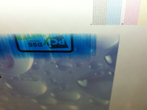

    Hello all! So I have a problem with my SC 540 Roland this morning. The print was going fine until the cyan started to spray all over the print. I've done a head cleaning and also a test print. Everything looks fine until I print something. I've tried other files as well. Here's a picture of what it looks like. Any ideas what the problem might be? Maybe a short on the circuit board?

    We ended up replacing the ribbons connected to the heads. That seemed to fix the problem!

    good fix and great follow-up on the thread!
    I was gonna chime-in, that you've got data issues and the ribbon cables are the easiest place to start.
