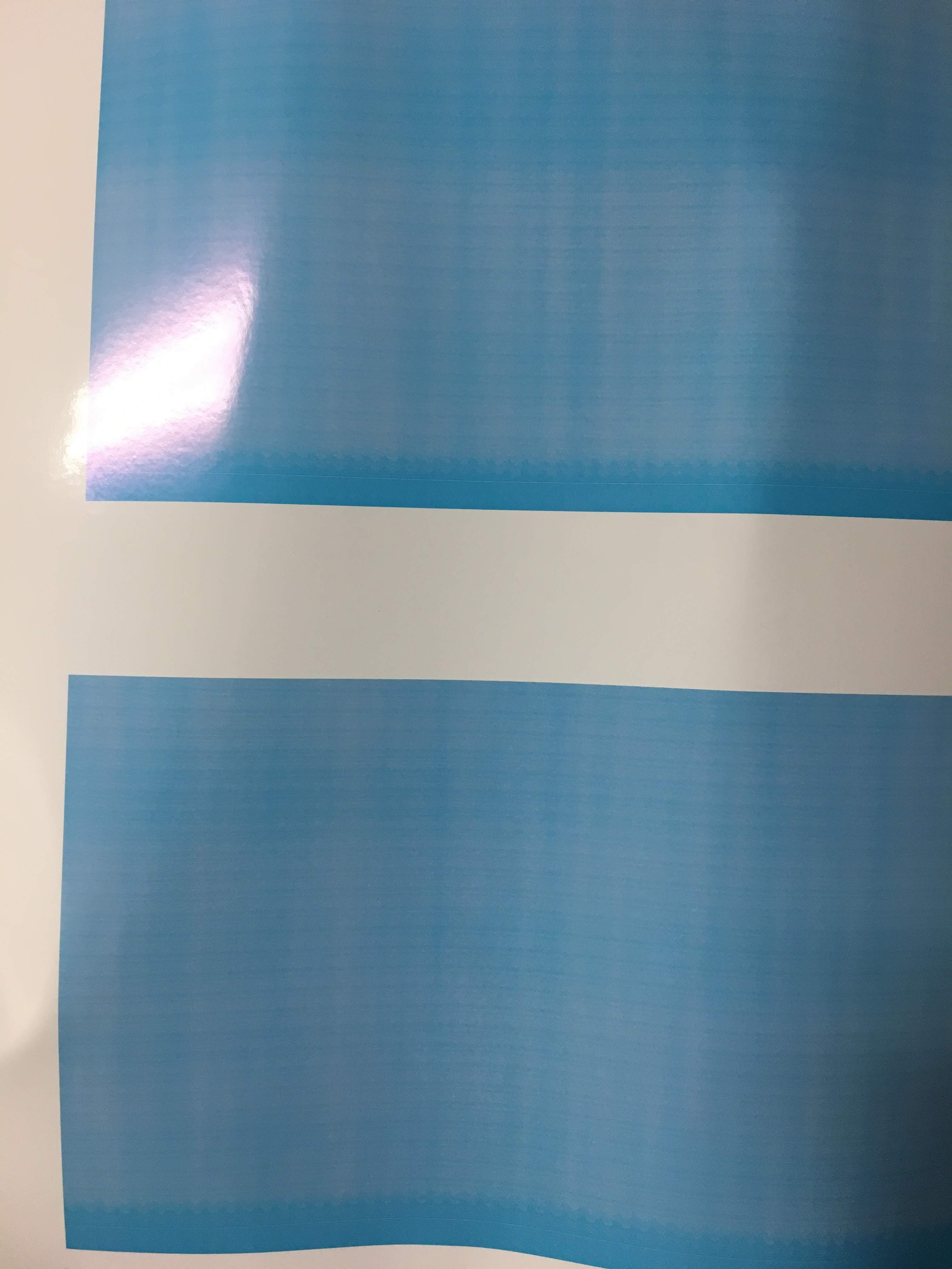

    I have a mutoh 1204 all my other colors are good, cyan starts out good then like slows down putting out ink,
    Real light like transparent not sure where to start looking for advice.

    Start with changing the dampers. Dampers keep ink flowing to the head and when they fail they do exactly what you describe.
