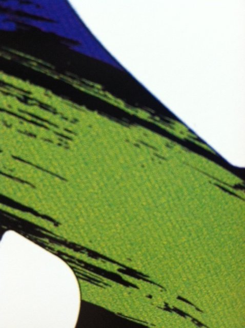

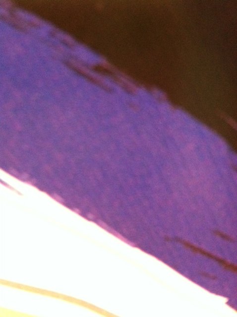

We tried it on both the substance and the prism jet vinyl and both had banding. Our problem is that when we use the substance vinyl the colors need to be good because the graphics are seen up close. Is there something in the rip we should try and adjust to get a better print.
CRD
No this is the abbility of the machine. What are the heater settings for both vinyls used?
What are you printing that needs high quality?
Attach a sample.
Paco
yamaha581
The rear heater is at 55 and the front is at 48.
We need the colors to be crisp because they are for graphics for dirt bikes, atvs, etc...
I attached a few pictures up close of the green and the dark blue.

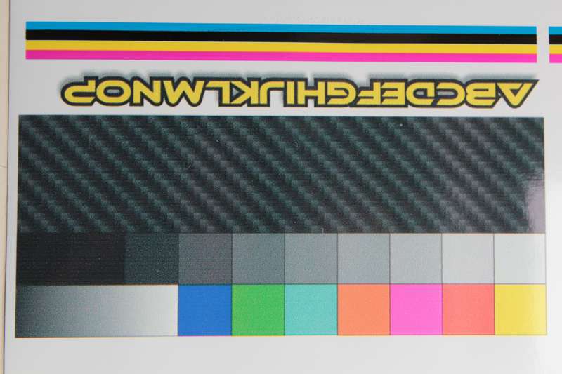

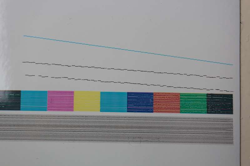

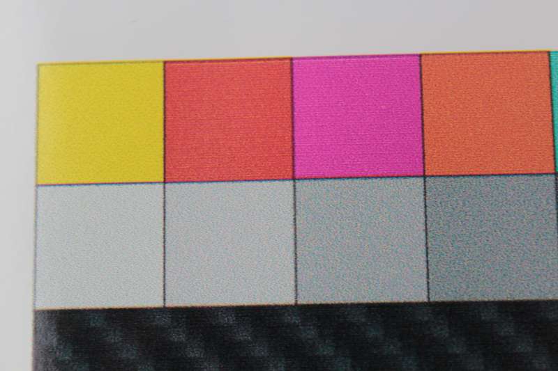

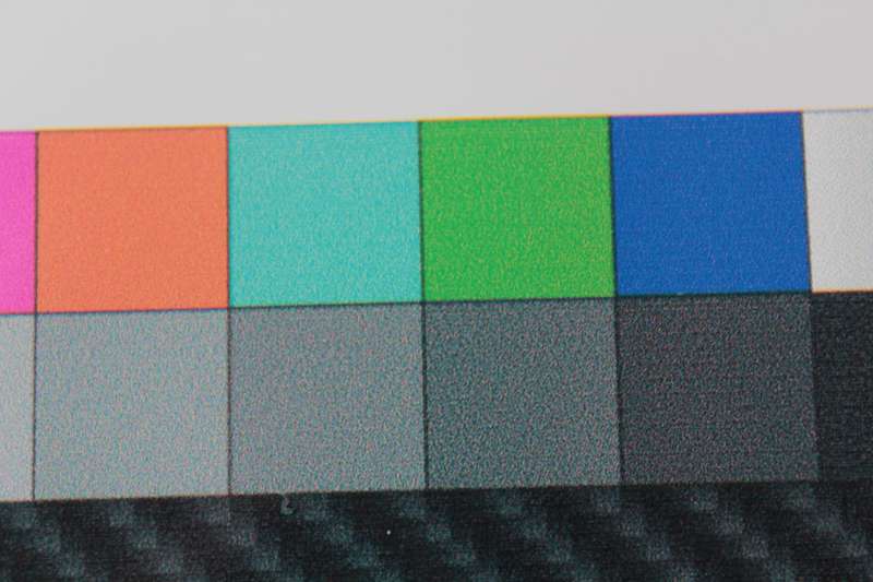

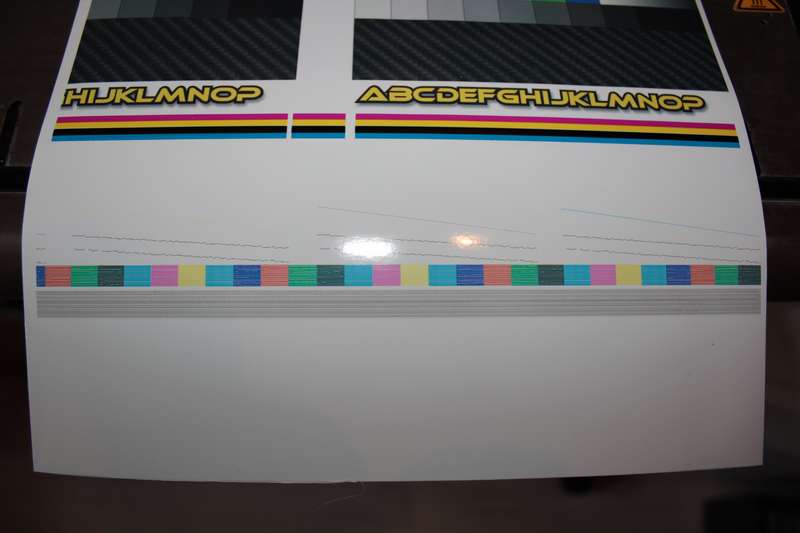

I am reworking one 38' machine now and will print and take picture for your reference.
Paco
CRD
Yamaha,
Here some promissed pics of a near ready '38 falcon junior.
Black needs a little shift upwards as there is a small space between black and yellow.
Black head needs a replacement but for now it works for the needs it is in use.
