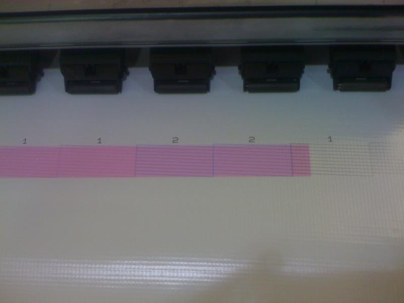

I am having a problem with the cyan printhead when I do test for nozzle check it lays down just one thick line of cyan. Does anybody know why it is doing this?
poslive
I had a similar problem recently only with light magenta. if it looks like this you may have a bad main board.

I just installed a new main board on my mutoh lt and i am getting an error but i dont know what the error is because everything is in japanese can anybody help me!!!
