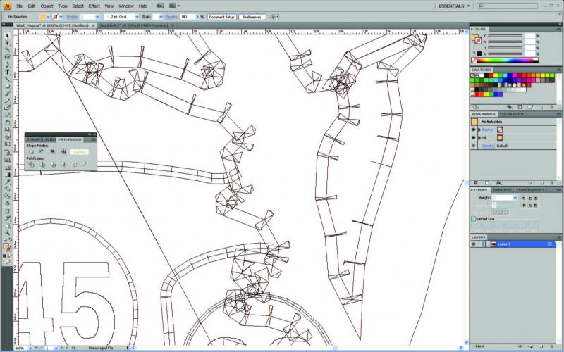

Greetings all, happy Saturday to you all. I have a customer supplied file that came from Freehand, sent to me in a pdf. It seems all of their outlines came across as a real mess and I need to clean them up.
I've contacted the customer and they told me "just fix it, I'm not dealing with the graphics guy again. Send me the bill for it".
Okay by me....
However, it's a REAL mess. All the outlines came across as thousands of tiny segments. Selecting the segments and welding together seems logical (and works), but there's so many segments and so many overlapping segments, it's almost impossible to get them all without getting ones I don't want.
Here's a screen shot of it. I could probably fix this fairly easily in Corel, but I'm trying to do it in Illustrator.
Any suggestions? Ideas? Getting another file is not an option. I don't mind charging them for it, but I'd rather not spend 8 hours working on it as I have other things I need to be doing.
The attached drawing is nothing more than outlines, but in wireframe view.
Thanks!
Steve

Try things like assigning a stroke, convert stroke to outlines, then do an inline to get back to the original size. You may have to experiment with whether or not it's compounded.

If you don't need to cut it, I'd just open it in photoshop at the final size and adequate resolution, flatten and tiff it. Depending on how big this is you can also rasterize from Illy. Select all then from object menu: rasterize. Choose the option you need.
If you must absolutely keep it in vector, try selecting all the segment that make up one shape and "add" from the pathfinder menu,then expand to make one path, although I,m not sure if it's gonna work.

Yes, it needs to be cut to profile, so that's the issue.
I'm slowly working it out in my head. I think I can lock the main shapes under these messes and use the pathfinder to weld them together. I'm working on it now. I just redid all the circles and numbers, deleting all those 50 segment circles. It wasn't too bad.
It's also about 70" long, so it's not a little bitty image.

That mess looks very much like what happens when software product A 's strokes are imported into software product B which doesn't understand product A's strokes. Only this time on steroids.
Perhaps that might be a clue as to how to deal with this Chinese fire drill.

I agree Bob. Looks like it totally hacked up all the strokes from Freehand.
It's not so bad. I've got it worked out for the most part. I just locked the items under these, selected large sections at a time and used pathfinder to unite them together. It's working fairly easily. Just takes a little time since it's such a large piece with so many things on it.
No big deal, it's easier than I thought it would be.
