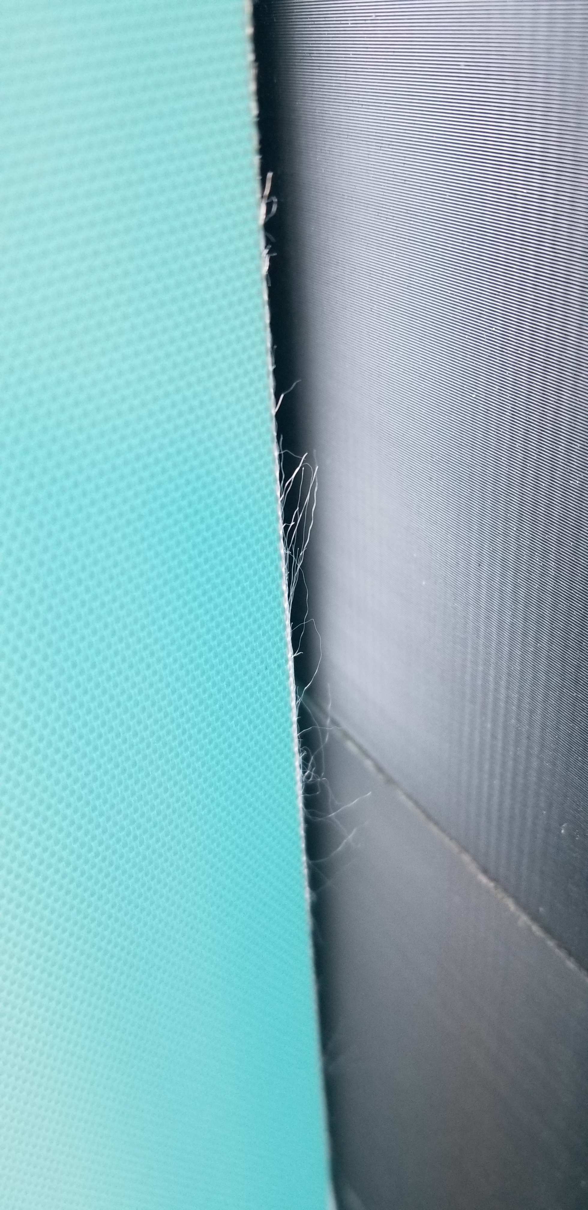

Is there a quick way to remove or prevent these strands from sticking out? I've tried using a lighter and it causes the strands to curl back and form a small ball, which isn't slightly either. I cant use any kind of hem tape because these are rolled and unrolled pretty tightly. I'm using an Olfa blade to cut them, so would a cutting wheel be better?

I use a Hot Knife to cut a clean edge on fabric like that so it does not unravel. I use a long aluminum ruler with cork applied to the bottom to hold the fabric from moving, however, I have noticed the aluminum ruler tends to draw the heat away from the cutting blade of the hot knife so I have to go really slow.
I know that glass is an insulator, so I plan to get a 36" long piece of 3/16" thick glass and have the edges smoothed, and apply a piece of self-adhesive swede or rubber pad to the bottom (to hold the fabric from slipping as cut), and use that as a straight cutting edge for the hot knife so if will not draw heat from the blade.
BTW: you can change out the blade for a longer one to cut sheets of foam, etc.
I cut fabric with the roller cutters. Big difference from a Xacto knife blade. I prefer the Yello Tool rulers and cutters. For the fabric that can unravel, a hot knife is a must. Get a good one, I use a HSGM hot knife. I have a sheet of aluminum that goes over the cutting table when cutting shapes. For other cuts, use a 2" wide -unpainted aluminum ruler under the cut so you don't destroy your tops

My initial thought was to cut a little wide and use hem glue - or take to a seamstress.

Use a hot knife to prevent frayed edges. To deal with edges that are fraying use a liquid called Fray Check. It's designed to seal raw edges of fabric. It's available at craft or sewing supply stores.
